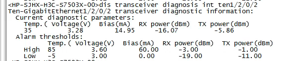

参考命令:dis transceiver diagnosis int g1/0/11
例如下图中收光RX为-16
收光范围为-3至-19,因此此收光正常,超出-19则不正常
输入查看光口率命令会有一个最低值,和最高值,在这个范围才行

2、display transceiver diagnosis interface
<M9010n>dis transceiver diagnosis interface M-GigabitEthernet1/0/0/0 transceiver diagnostic information: The operation is not supported. Ten-GigabitEthernet1/0/0/1 transceiver diagnostic information: The transceiver is absent. Ten-GigabitEthernet1/0/0/2 transceiver diagnostic information: Current diagnostic parameters: Temp.(?? Voltage(V) Bias(mA) RX power(dBm) TX power(dBm) 22 3.39 3.98 -6.73 -5.65 Alarm thresholds: Temp.(?? Voltage(V) Bias(mA) RX power(dBm) TX power(dBm) High 90 3.63 12.75 3.00 0.00 Low -10 2.97 2.00 -21.02 -13.50 Ten-GigabitEthernet1/0/0/4 transceiver diagnostic information: Reading information from the transceiver failed.
