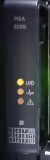

请问MSA2050三种灯分别是什么意思,是否有这种硬件介绍文档
4
Unit Identification (UID)
  • Blue - Identified.
  • Off - Identity LED off.
5
Heartbeat
  • Green - The enclosure is powered on with at least one power supply operating normally.
  • Off - Both power supplies are off; the system is powered off.
6
Fault ID
  • Amber - Fault condition exists. The event has been identified, but the problem needs attention.
  • Off - No fault condition exists
详细请参考:
https://support.hpe.com/hpesc/public/docDisplay?docId=emr_na-a00022005en_us

可以看一下MSA User Guide
