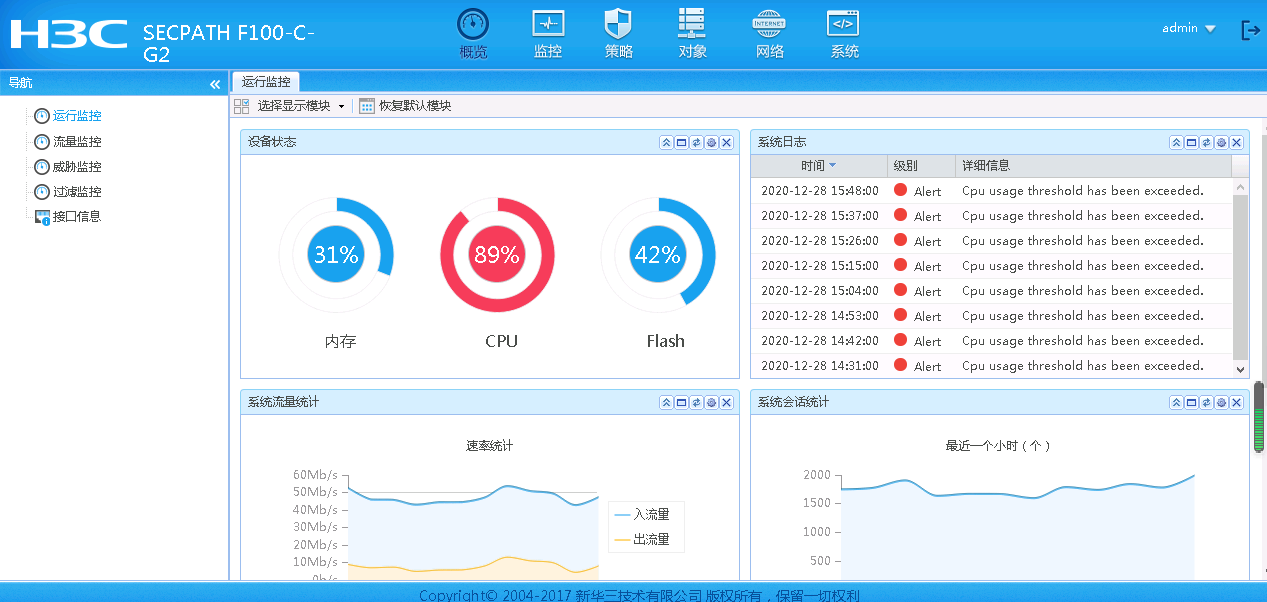

SECPATH F100-C-G2防火墙cpu始终90%以上
2020-12-28提问
  • 1收藏,4868浏览
youfly 零段
cpu始终90%左右
设置列表
  • 有序列表
  • 无序列表
重启后cpu依旧,具体诊断信息见附件

2042 2042 0.3 0.0 S 120 - 00:00:00 sshd
2044 2044 0.0 0.0 S 120 - 00:00:00 login -f --ipv4 172.17
2046 2046 0.0 0.0 S 120 - 00:00:00 comshc shell level 0
2047 2047 0.2 0.2 S 120 pts/0 00:00:00 comsh server
2050 2050 0.1 0.2 S 120 pts/0 00:00:00 comsh server
2051 2051 0.6 0.2 S 120 pts/0 00:00:00 comsh server
[xlfirewall]
主要是
44 44 29.4 0.0 D 115 - 01:09:48 [kdrvdp1]
176 176 46.4 0.0 R 115 - 02:05:08 [karp/1]
具体要看看配置了什么  有些命名好资源的
[xlfirewall]dis cur # version 7.1.064, Release 9510P06 # sysname xlfirewall # clock timezone Beijing add 08:00:00 clock protocol none # context Admin id 1 # irf mac-address persistent timer irf auto-update enable undo irf link-delay irf member 1 priority 1 # port-mapping application ftp port 821 # password-recovery enable # vlan 1 # object-group ip address 0 description 外网 0 network subnet 0.0.0.0 0.0.0.0 # object-group ip address 172 description 172网段 0 network subnet 172.172.0.0 255.255.252.0 # object-group ip address 172trust description 允许通过防火墙映射公网的172地址 0 network host address 172.172.0.160 10 network host address 172.172.0.167 20 network host address 172.172.1.142 30 network host address 172.172.2.22 40 network host address 172.172.2.91 50 network host address 172.172.3.51 60 network host address 172.172.3.52 70 network host address 172.172.3.54 80 network host address 172.172.2.80 90 network host address 172.172.3.8 100 network host address 172.172.3.7 110 network host address 172.172.3.33 120 network host address 172.172.3.34 130 network host address 172.172.3.56 140 network host address 172.172.1.141 150 network host address 172.172.3.67 160 network host address 172.172.1.150 # object-group ip address 172管理 description 能访问199网段的172段地址 # object-group ip address 199 # object-group ip address dmz-ip # object-group ip address dmz开放 # object-group ip address trust-ip 0 network host address 172.172.0.3 # object-group ip address untrust-ip 0 network host address 221.181.216.10 # object-group ip address 网段0 0 network range 172.172.0.10 172.172.0.254 # object-group ip address 网段1 0 network range 172.172.1.1 172.172.1.254 # object-group ip address 网段2 0 network range 172.172.2.1 172.172.2.254 # object-group ip address 网段3 0 network range 172.172.3.40 172.172.3.254 # interface NULL0 # interface GigabitEthernet1/0/0 port link-mode route combo enable copper ip address 192.168.0.1 255.255.255.0 undo dhcp select server # interface GigabitEthernet1/0/1 port link-mode route combo enable fiber undo dhcp select server # interface GigabitEthernet1/0/2 port link-mode route ip address 192.168.1.1 255.255.255.0 undo dhcp select server # interface GigabitEthernet1/0/3 port link-mode route ip address XX dns server XX dns server 112.4.0.55 nat outbound 3172 undo dhcp select server # interface GigabitEthernet1/0/4 port link-mode route ip address 172.172.0.3 255.255.252.0 nat outbound 3172 nat hairpin enable # interface GigabitEthernet1/0/5 port link-mode route undo dhcp select server # interface GigabitEthernet1/0/6 port link-mode route undo dhcp select server # interface GigabitEthernet1/0/7 port link-mode route undo dhcp select server # interface GigabitEthernet1/0/8 port link-mode route undo dhcp select server # interface GigabitEthernet1/0/9 port link-mode route undo dhcp select server # interface GigabitEthernet1/0/10 port link-mode route ip address 199.199.199.1 255.255.255.0 undo dhcp select server # interface GigabitEthernet1/0/11 port link-mode route undo dhcp select server # object-policy ip Any-Any rule 0 pass source-ip 0 destination-ip 172trust # object-policy ip DMZ-Local rule 0 pass source-ip 199 destination-ip dmz-ip # object-policy ip DMZ-Trust rule 0 pass source-ip 199 destination-ip 172 # object-policy ip DMZ-Untrust rule 0 pass source-ip 199 destination-ip 0 # object-policy ip Local-DMZ rule 0 pass source-ip dmz-ip destination-ip 199 # object-policy ip Local-Trust rule 0 pass source-ip trust-ip destination-ip 172 # object-policy ip Local-Untrust rule 0 pass source-ip untrust-ip destination-ip 0 # object-policy ip Trust-Any rule 0 pass source-ip 0 destination-ip 0 # object-policy ip Trust-DMZ rule 0 pass source-ip 172管理 destination-ip 199 # object-policy ip Trust-Local rule 0 pass source-ip 172 destination-ip trust-ip # object-policy ip Trust-Trust rule 0 pass source-ip 172 destination-ip 172 # object-policy ip Trust-Untrust rule 0 pass source-ip 172trust destination-ip 0 rule 1 pass source-ip 172 destination-ip 0 # object-policy ip Untrust-DMZ rule 0 pass source-ip 0 destination-ip dmz开放 # object-policy ip Untrust-Local rule 0 pass source-ip 0 destination-ip untrust-ip # object-policy ip Untrust-Trust rule 0 pass source-ip 0 destination-ip 172trust rule 1 pass source-ip 0 destination-ip 172 # security-zone name Local # security-zone name Trust import interface GigabitEthernet1/0/4 # security-zone name DMZ import interface GigabitEthernet1/0/10 # security-zone name Untrust import interface GigabitEthernet1/0/3 blacklist enable # security-zone name Management import interface GigabitEthernet1/0/0 import interface GigabitEthernet1/0/2 # zone-pair security source Any destination Any object-policy apply ip Any-Any # zone-pair security source DMZ destination Local object-policy apply ip DMZ-Local # zone-pair security source DMZ destination Trust object-policy apply ip DMZ-Trust # zone-pair security source DMZ destination Untrust object-policy apply ip DMZ-Untrust # zone-pair security source Local destination DMZ object-policy apply ip Local-DMZ # zone-pair security source Local destination Trust object-policy apply ip Local-Trust # zone-pair security source Local destination Untrust object-policy apply ip Local-Untrust # zone-pair security source Trust destination Any object-policy apply ip Trust-Any # zone-pair security source Trust destination DMZ object-policy apply ip Trust-DMZ # zone-pair security source Trust destination Local object-policy apply ip Trust-Local # zone-pair security source Trust destination Trust object-policy apply ip Trust-Trust # zone-pair security source Trust destination Untrust object-policy apply ip Trust-Untrust # zone-pair security source Untrust destination DMZ object-policy apply ip Untrust-DMZ # zone-pair security source Untrust destination Local object-policy apply ip Untrust-Local # zone-pair security source Untrust destination Trust object-policy apply ip Untrust-Trust # scheduler logfile size 16 # line class aux user-role network-operator # line class console user-role network-admin # line class vty user-role network-operator # line aux 0 user-role network-admin # line con 0 authentication-mode scheme user-role network-admin # line vty 0 4 authentication-mode scheme user-role network-admin protocol inbound ssh # line vty 5 63 authentication-mode scheme user-role network-admin # ip route-static 0.0.0.0 0 221.181.216.9 # ssh server enable # time-range 工作时间 08:15 to 17:45 working-day # acl basic 2000 rule 0 permit source 172.172.0.0 0.0.0.255 rule 5 permit source 172.172.1.0 0.0.0.255 rule 10 permit source 172.172.2.0 0.0.0.255 rule 15 permit source 172.172.3.0 0.0.0.255 # acl advanced 3172 rule 0 permit ip source 172.172.0.0 0.0.0.255 rule 5 permit tcp source 172.172.0.0 0.0.0.255 rule 10 permit ip source 172.172.1.0 0.0.0.255 rule 15 permit tcp source 172.172.1.0 0.0.0.255 rule 20 permit tcp source 172.172.2.0 0.0.0.255 rule 25 permit tcp source 172.172.3.0 0.0.0.255 rule 30 permit ip source 172.172.3.0 0.0.0.255 rule 35 permit ip source 172.172.2.0 0.0.0.255 # acl advanced 3333 rule 0 permit ip # domain system # aaa session-limit ftp 16 aaa session-limit telnet 16 aaa session-limit ssh 16 domain default enable system # role name level-0 description Predefined level-0 role # role name level-1 description Predefined level-1 role # role name level-2 description Predefined level-2 role # role name level-3 description Predefined level-3 role # role name level-4 description Predefined level-4 role # role name level-5 description Predefined level-5 role # role name level-6 description Predefined level-6 role # role name level-7 description Predefined level-7 role # role name level-8 description Predefined level-8 role # role name level-9 description Predefined level-9 role # role name level-10 description Predefined level-10 role # role name level-11 description Predefined level-11 role # role name level-12 description Predefined level-12 role # role name level-13 description Predefined level-13 role # role name level-14 description Predefined level-14 role # user-group system # local-user admin class manage password hash $h$6$wjtCJPmuhZDQdZp5$aQEG01EvYsdxqyEk+AQAwNXmdub2WW7eziMofD5oM63lAqsJqVAuZeZe4bL4pkquk2x8xsDuLyLAQ96q1LmhKg== service-type ssh terminal https authorization-attribute user-role level-3 authorization-attribute user-role network-admin authorization-attribute user-role network-operator # local-user xladmin class manage password hash $h$6$KcZd+O16oNaE7Mvv$Eex8rL0ByEMMafNePssk/AhODYbh2otnxaXy/S5M21nf7RGzhBzmeZ8O2RDcXtHEM3yDr9O3/2MNYBscJEPMEA== service-type ssh terminal https authorization-attribute user-role level-3 authorization-attribute user-role network-operator # session statistics enable session top-statistics enable # ip https enable # blacklist ip 167.99.37.148 blacklist ip 178.33.145.241 blacklist global enable # attack-defense policy 1 scan detect level low action drop logging syn-flood action logging ack-flood action logging syn-ack-flood action logging rst-flood action logging fin-flood action logging udp-flood action logging icmp-flood action logging icmpv6-flood action logging dns-flood action logging http-flood action logging signature detect fragment action logging signature detect impossible action logging signature detect teardrop action drop logging signature detect tiny-fragment action logging signature detect ip-option-abnormal action drop logging signature detect smurf action logging signature detect traceroute action logging signature detect ping-of-death action drop logging signature detect large-icmp action logging signature detect large-icmpv6 action logging signature detect tcp-invalid-flags action logging signature detect tcp-null-flag action logging signature detect tcp-all-flags action logging signature detect tcp-syn-fin action logging signature detect tcp-fin-only action logging signature detect land action logging signature detect winnuke action logging signature detect udp-bomb action logging signature detect snork action logging signature detect fraggle action logging # inspect block-source parameter-profile ips_block_default_parameter # inspect block-source parameter-profile url_block_default_parameter # inspect capture parameter-profile ips_capture_default_parameter # inspect logging parameter-profile ips_logging_default_parameter # inspect logging parameter-profile url_logging_default_parameter # inspect redirect parameter-profile av_redirect_default_parameter # inspect redirect parameter-profile ips_redirect_default_parameter # inspect redirect parameter-profile url_redirect_default_parameter # traffic-policy rule name 网段0 time-range 工作时间 action qos profile 带宽0 source-address address-set 网段0 destination-address address-set 0 source-zone Trust destination-zone Untrust rule name 网段1 time-range 工作时间 action qos profile 带宽1 source-address address-set 网段1 destination-address address-set 0 source-zone Trust destination-zone Untrust rule name 网段2 time-range 工作时间 action qos profile 带宽2 source-address address-set 网段2 destination-address address-set 0 source-zone Trust destination-zone Untrust rule name 网段3 time-range 工作时间 action qos profile 带宽3 source-address address-set 网段3 destination-address address-set 0 source-zone Trust destination-zone Untrust profile name 带宽0 bandwidth downstream guaranteed 100 bandwidth downstream maximum 15000 bandwidth upstream guaranteed 100 bandwidth upstream maximum 15000 connection-limit count per-ip 300 bandwidth upstream maximum per-ip 3000 bandwidth downstream maximum per-ip 4000 profile name 带宽1 bandwidth downstream guaranteed 100 bandwidth downstream maximum 15000 bandwidth upstream guaranteed 100 bandwidth upstream maximum 15000 connection-limit count per-ip 300 bandwidth upstream maximum per-ip 3000 bandwidth downstream maximum per-ip 4000 profile name 带宽2 bandwidth downstream guaranteed 100 bandwidth downstream maximum 15000 bandwidth upstream guaranteed 100 bandwidth upstream maximum 15000 connection-limit count per-ip 300 bandwidth upstream maximum per-ip 3000 bandwidth downstream maximum per-ip 4000 profile name 带宽3 bandwidth downstream guaranteed 100 bandwidth downstream maximum 15000 bandwidth upstream guaranteed 100 bandwidth upstream maximum 15000 connection-limit count per-ip 300 bandwidth upstream maximum per-ip 3000 bandwidth downstream maximum per-ip 4000 # ips block-source parameter-profile ips_block_default_parameter # return [xlfirewall] 主要配置
youfly 发表时间:2020-12-28 更多>>
