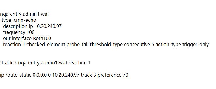

NQA配置:
nqa entry admin test
[admin-test]type icmp-echo
[admin-test-icmp-echo]destination ***
[admin-test-icmp-echo]next-hop ip ***
[admin-test-icmp-echo]probe count 10        //UDP-tracert默认3次,其他类型默认1次
[admin-test-icmp-echo]probe timeout 500  //默认是3000毫秒
[admin-test-icmp-echo]frequency 5000      //两次测试开始的时间间隔
[admin-test-icmp-echo]history-record enable
[admin-test-icmp-echo]history-record number 10
nqa schedule admin test start-time now lifetime forever
和track联动:
[admin-test-icmp-echo]reaction 1  checked-element probe-fail threshold-type
          consecutive 5 action-type trigger-only
track 1 nqa entry admin test reaction 1
溪 四段
粉丝:3人 关注:2人
写错了,应该是destination ip
然后再
nqa schedule admin1 waf start-time now lifetime forever
忘采纳
