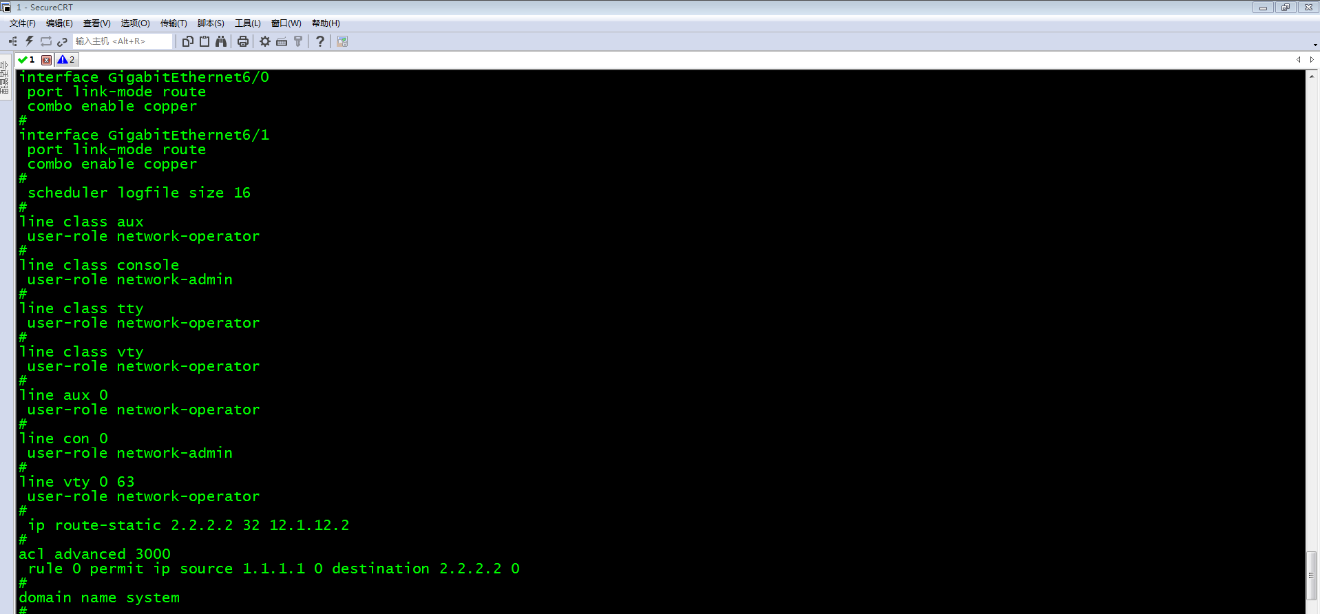

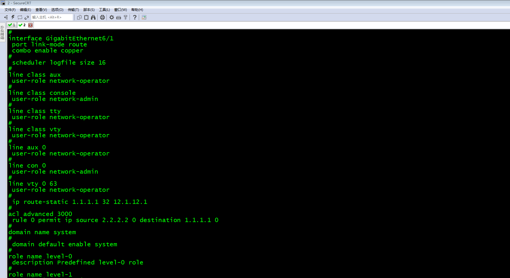

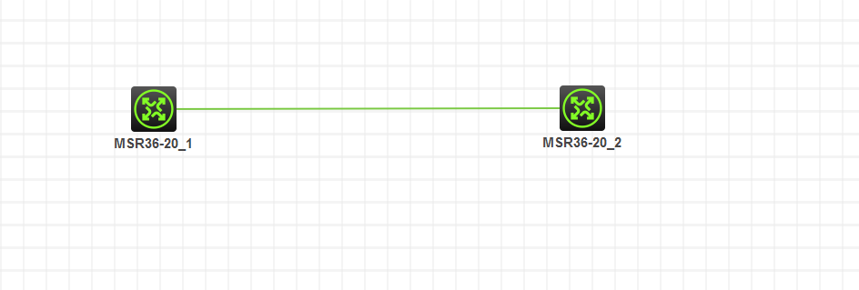

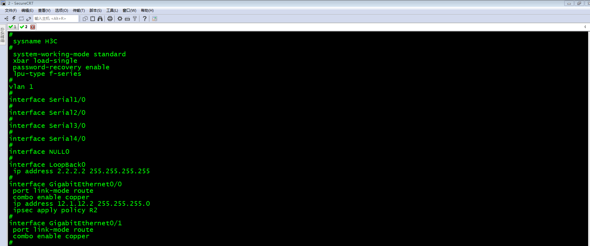

我刚刚问的IPSEC,现在直接贴配置吧,请大神看看,问题出在哪??

好的 稍等 我看下

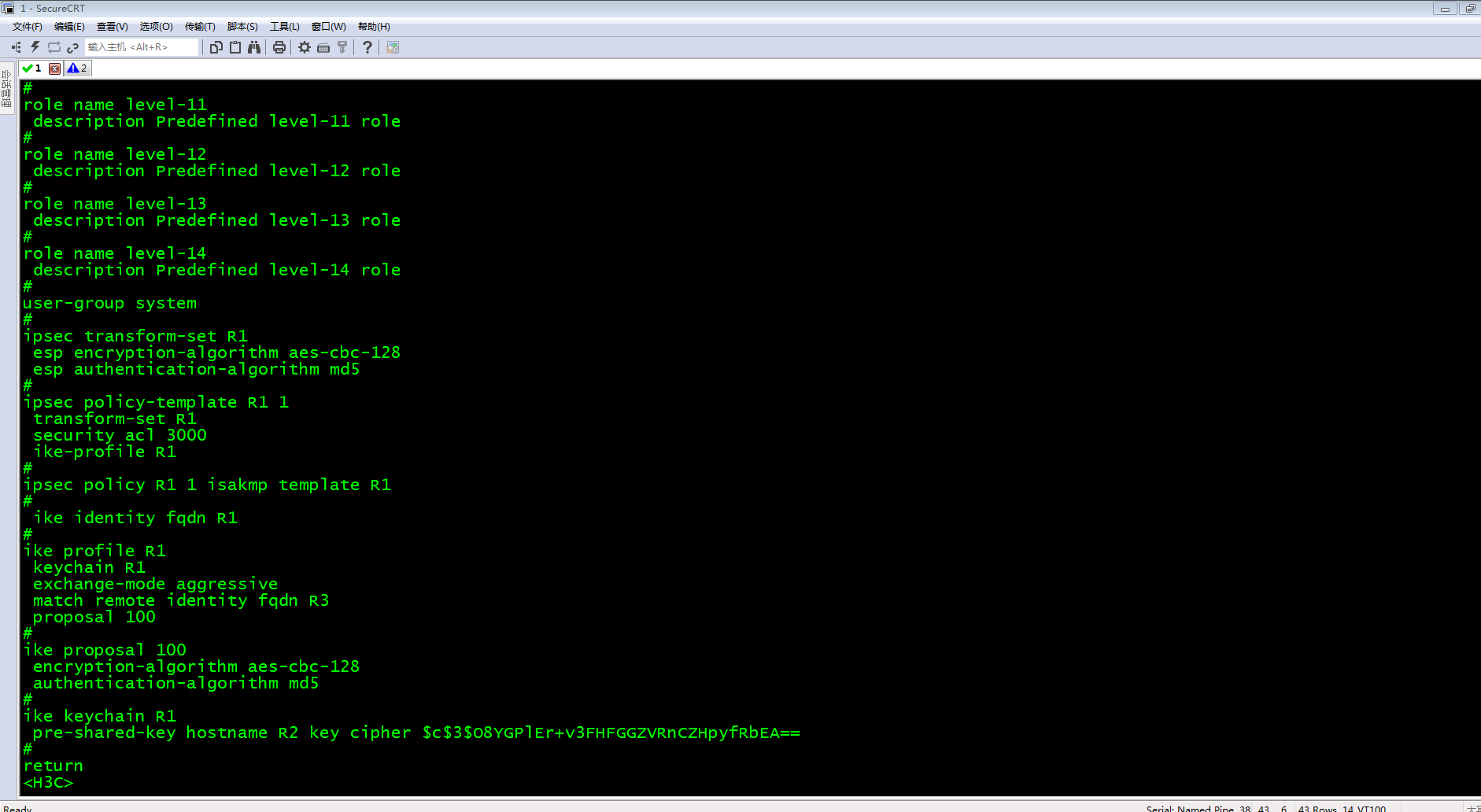

ike profile R1 keychain R1 exchange-mode aggressive match remote identity fqdn R3 proposal 100 官网手册地址链接

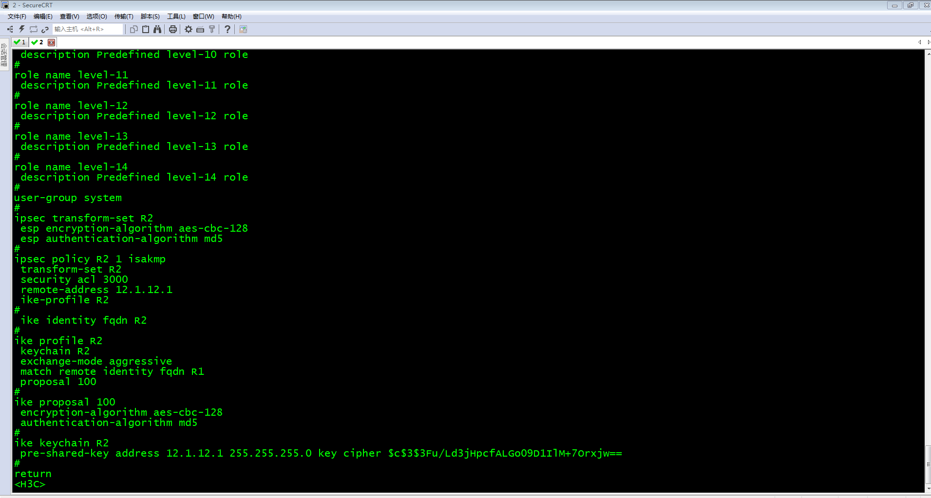

R1这边的keychain先改下吧,和R2一致 改成地址的形式 ike keychain R1 pre-shared-key hostname R2 key cipher $c$3$O8YGPlEr+v3FHFGGZVRnCZHpyfRbEA== # ike keychain R2 pre-shared-key address 12.1.12.1 255.255.255.0 key cipher $c$3$3Fu/Ld3jHpcfALGo09D1IlM+7Orxjw==

ike profile R1 keychain R1 exchange-mode aggressive match remote identity fqdn R3 proposal 100 ike profile写错了吧,是R2吧 先照官网配置手册检查下配置吧 ,还有问题的话 debug ike all和ipsec all,t d 和t m打开。重新触发下流量看下
