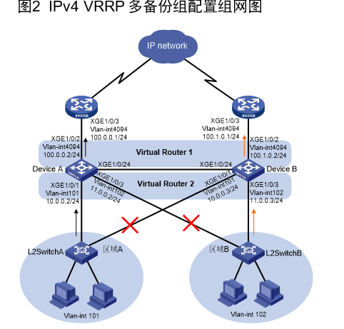

默认不检测,可以加track:
VRRP、Track与NQA联动配置举例(Master监视上行链路)
https://www.h3c.com/cn/d_202106/1413529_30005_0.htm#_Toc73558388
