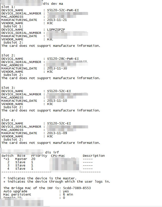

客户现场有S5120-52C-PWR-EI和S5120-52C-EI堆叠的情况,使用display ver 命令只显示Master的型号,这种情况怎么查看Slave的型号?

dis  dev  ma  应该可以看到备机型号

Slot 1: DEVICE_NAME : S5120-52C-PWR-EI DEVICE_SERIAL_NUMBER : 210235A0JTH13B000103 MAC_ADDRESS : 5CDD-7089-9093 MANUFACTURING_DATE : 2013-11-21 VENDOR_NAME : H3C Subslot 1: DEVICE_NAME : LSPM2SP2P DEVICE_SERIAL_NUMBER : 210231A98LC13B000233 MANUFACTURING_DATE : 2013-11-18 VENDOR_NAME : H3C Subslot 2: The card does not support manufacture information. Slot 2: DEVICE_NAME : S5120-52C-EI DEVICE_SERIAL_NUMBER : 210235A0BMH13B000237 MAC_ADDRESS : 5CDD-7014-558C MANUFACTURING_DATE : 2013-11-09 VENDOR_NAME : H3C Subslot 2: The card does not support manufacture information. Slot 3: DEVICE_NAME : S5120-52C-EI DEVICE_SERIAL_NUMBER : 210235A0BMH13B000422 MAC_ADDRESS : 5CDD-7014-83CC MANUFACTURING_DATE : 2013-11-11 VENDOR_NAME : H3C Subslot 2: The card does not support manufacture information. Slot 4: DEVICE_NAME : S5120-52C-EI DEVICE_SERIAL_NUMBER : 210235A0BMH13B000281 MAC_ADDRESS : 5CDD-7014-608C MANUFACTURING_DATE : 2013-11-09 VENDOR_NAME : H3C Subslot 2: The card does not support manufacture information. 这个IRF成员里面有三种型号的设备,人都麻了

只有相同型号的才能堆叠
另外如果实在想看:
dir slot2#flash:/
dir slot1#flash:/
根据槽位dir看下

但是的确有不同型号堆叠的情况,也不知道当时建设的时候是怎么做到的,现在的情况就是带poe的和不带poe的堆叠在一起了
