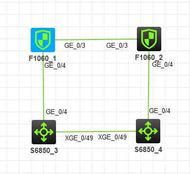

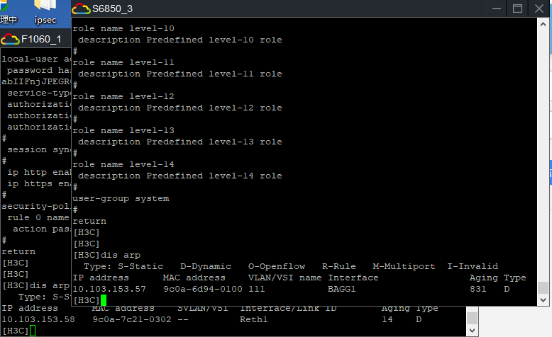

防火墙堆叠用Reth口对接下联交换机,交换机用的二层聚合口access和vlanif对接,发现直连ping不通,能看到arp
防火墙交换机两两堆叠
防火墙配置
interface Reth1
 ip address 10.103.153.57 255.255.255.248
 member interface GigabitEthernet1/0/4 priority 255
 member interface GigabitEthernet2/0/4 priority 50
security-zone name Trust
 import interface Reth1
security-policy ip
 rule 0 name 0
 action pass
交换机配置
interface Bridge-Aggregation1
 port access vlan 111
interface Vlan-interface111
 ip address 10.103.153.58 255.255.255.248
 port link-mode bridge
 combo enable fiber
 port link-aggregation group 1
 combo enable fiber
