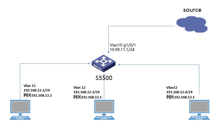

  实际环境有些不同,我只有1个s5500 ei交换机,而且组播源不是pim-dm协议,只有igmp-snooping
配置
新建vlan10 端口1       IP10.99.11.1/24
vlan12 端口9-12        IP192.168.12.1/24
使能组播路由
[h3c] multicast routing-enable
[h3c] interface vlan-interface 10
[h3c-Vlan-interface10] igmp proxying enable
[h3c-Vlan-interface10] quit
[h3c] interface vlan-interface 12
[h3c-Vlan-interface12] igmp enable
[h3c-Vlan-interface12] quit
但是没能正常播放组播。是配置不对,还是必须要2个交换机才行。试过4个端口在同一vlan内,配置igmp-snooping是可以正常播放的
[h3c] igmp-snooping
[h3c-igmp-snooping] quit
[h3c] vlan 12
[h3c-vlan100] port gigabitethernet 1/0/9 to gigabitethernet 1/0/12
[h3c-vlan12] igmp-snooping enable
[h3c-vlan12] igmp-snooping proxying enable
[h3c-vlan12] quit

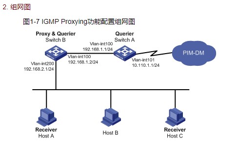

官网案例链接https://www.h3c.com/cn/d_202111/1487842_30005_0.htm,可以在对一下

谢谢,我再看下
