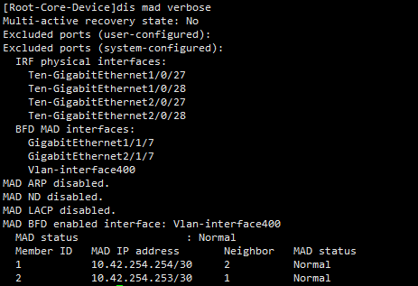

检测线路的两个地址都能ping通,但IRF分裂后BFD不切换为UP状态,求大佬解答,上图:

贴配置如下:
irf mac-address persistent timer
irf auto-update enable
undo irf link-delay
irf member 1 priority 20
irf member 2 priority 1
irf member 1 description root_A
vlan 1
vlan 100
vlan 400
irf-port 1/1
port group interface Ten-GigabitEthernet1/0/27
irf-port 1/2
port group interface Ten-GigabitEthernet1/0/28
irf-port 2/1
port group interface Ten-GigabitEthernet2/0/28
irf-port 2/2
port group interface Ten-GigabitEthernet2/0/27
stp global enable

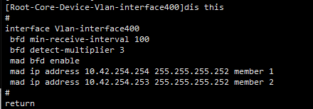

interface Vlan-interface100
ip address 10.42.100.1 255.255.255.0
interface Vlan-interface400
bfd min-receive-interval 100
bfd detect-multiplier 3
mad bfd enable
mad ip address 10.42.254.254 255.255.255.252 member 1
mad ip address 10.42.254.253 255.255.255.252 member 2
interface GigabitEthernet1/1/7
port link-mode bridge
port access vlan 400
undo stp enable
interface GigabitEthernet2/1/7
undo stp enable

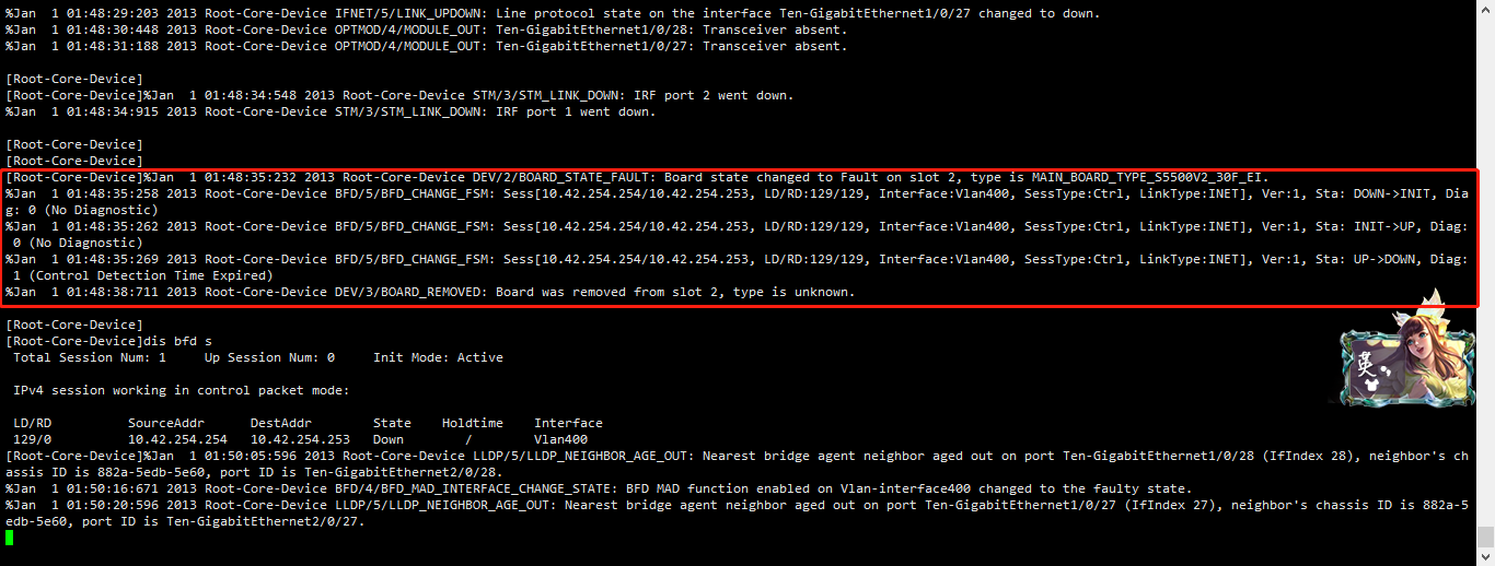

分裂后提示如下:

检查下1/1/7和2/1/7是否关闭了stp
以及其它端口是否放通了vlan 400
也就是严格按照配置文档要求核对下吧
如果怀疑是扩展板卡问题,建议找前置固化端口替换测试看看呗

其他端口没有放通这个vlan,STP也关了,一步一步按照文档做的,我检测线是用的扩展卡上的接口,这个会不会影响
