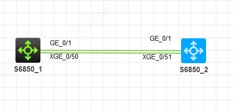

叠配置了mad,之后CPU之间达到90%,卡死
2022-03-22提问
  • 1收藏,3208浏览
<H3C>dis logbuffer reverse Log buffer: Enabled Max buffer size: 1024 Actual buffer size: 512 Dropped messages: 0 Overwritten messages: 0 Current messages: 169 %Mar 22 11:01:09:761 2022 H3C SHELL/6/SHELL_CMD: -Line=con0-IPAddr=**-User=**; Command is dis logbuffer %Mar 22 11:01:00:480 2022 H3C SHELL/6/SHELL_CMD: -Line=con0-IPAddr=**-User=**; Command is dis cpu-usage %Mar 22 11:00:57:122 2022 H3C SHELL/5/SHELL_LOGIN: Console logged in from con0. %Mar 22 11:00:48:605 2022 H3C IFNET/5/LINK_UPDOWN: Line protocol state on the interface Vlan-interface10 changed to down. %Mar 22 11:00:48:605 2022 H3C IFNET/3/PHY_UPDOWN: Physical state on the interface Vlan-interface10 changed to down. %Mar 22 11:00:46:557 2022 H3C DEV/3/BOARD_REMOVED: Board was removed from slot 2, type is H3C S6850. %Mar 22 11:00:46:554 2022 H3C HA/5/HA_STANDBY_TO_MASTER: Standby board in slot 1 changed to master. %Mar 22 11:00:46:553 2022 H3C LIPC/5/PORT_CHANGE: [!karp/1/897877] STCP: Node where the listening port number 1637 (MDC:1 VRF:0) resides changed from LIP 16 to LIP 8. %Mar 22 11:00:46:553 2022 H3C LIPC/5/PORT_CHANGE: [!karp/1/897877] STCP: Node where the listening port number 1638 (MDC:1 VRF:0) resides changed from LIP 16 to LIP 8. %Mar 22 11:00:46:553 2022 H3C LIPC/5/PORT_CHANGE: [!kspbm/1/897877] STCP: Node where the listening port number 1744 (MDC:1 VRF:0) resides changed from LIP 16 to LIP 8. %Mar 22 11:00:46:553 2022 H3C LIPC/5/PORT_CHANGE: [!kspbm/1/897877] STCP: Node where the listening port number 1745 (MDC:1 VRF:0) resides changed from LIP 16 to LIP 8. %Mar 22 11:00:46:552 2022 H3C LIPC/5/PORT_CHANGE: [!kfib/1/897876] STCP: Node where the listening port number 4255 (MDC:1 VRF:0) resides changed from LIP 16 to LIP 8. %Mar 22 11:00:46:552 2022 H3C LIPC/5/PORT_CHANGE: [!kfib/1/897876] STCP: Node where the listening port number 1646 (MDC:1 VRF:0) resides changed from LIP 16 to LIP 8. %Mar 22 11:00:46:552 2022 H3C LIPC/5/PORT_CHANGE: [!kfib/1/897876] STCP: Node where the listening port number 1655 (MDC:1 VRF:0) resides changed from LIP 16 to LIP 8. %Mar 22 11:00:46:552 2022 H3C LIPC/5/PORT_CHANGE: [!kTMFIB//897876] STCP: Node where the listening port number 1677 (MDC:1 VRF:0) resides changed from LIP 16 to LIP 8. %Mar 22 11:00:46:552 2022 H3C LIPC/5/PORT_CHANGE: [!kTMFIB//897876] STCP: Node where the listening port number 1678 (MDC:1 VRF:0) resides changed from LIP 16 to LIP 8. %Mar 22 11:00:46:552 2022 H3C LIPC/5/PORT_CHANGE: [!kmac/1/897876] STCP: Node where the listening port number 1782 (MDC:1 VRF:0) resides changed from LIP 16 to LIP 8. %Mar 22 11:00:46:552 2022 H3C LIPC/5/PORT_CHANGE: [!kmac/1/897876] STCP: Node where the listening port number 1783 (MDC:1 VRF:0) resides changed from LIP 16 to LIP 8. %Mar 22 11:00:46:552 2022 H3C LIPC/5/PORT_CHANGE: [!kmac/1/897876] STCP: Node where the listening port number 1784 (MDC:1 VRF:0) resides changed from LIP 16 to LIP 8. %Mar 22 11:00:46:552 2022 H3C LIPC/5/PORT_CHANGE: [!kmac/1/897876] STCP: Node where the listening port number 1715 (MDC:1 VRF:0) resides changed from LIP 16 to LIP 8. %Mar 22 11:00:46:552 2022 H3C LIPC/5/PORT_CHANGE: [!kmac/1/897876] STCP: Node where the listening port number 1663 (MDC:1 VRF:0) resides changed from LIP 16 to LIP 8. %Mar 22 11:00:46:552 2022 H3C LIPC/5/PORT_CHANGE: [!kmac/1/897876] STCP: Node where the listening port number 1844 (MDC:1 VRF:0) resides changed from LIP 16 to LIP 8. %Mar 22 11:00:46:552 2022 H3C LIPC/5/PORT_CHANGE: [!kmac/1/897876] STCP: Node where the listening port number 1664 (MDC:1 VRF:0) resides changed from LIP 16 to LIP 8. %Mar 22 11:00:46:552 2022 H3C LIPC/5/PORT_CHANGE: [!kwadj/1/897876] STCP: Node where the listening port number 1640 (MDC:1 VRF:0) resides changed from LIP 16 to LIP 8. %Mar 22 11:00:46:552 2022 H3C LIPC/5/PORT_CHANGE: [!kwadj/1/897876] STCP: Node where the listening port number 1641 (MDC:1 VRF:0) resides changed from LIP 16 to LIP 8. %Mar 22 11:00:46:552 2022 H3C LIPC/5/PORT_CHANGE: [!sock/1/897876] STCP: Node where the listening port number 1644 (MDC:1 VRF:0) resides changed from LIP 16 to LIP 8. %Mar 22 11:00:46:552 2022 H3C LIPC/5/PORT_CHANGE: [!sock/1/897876] STCP: Node where the listening port number 1643 (MDC:1 VRF:0) resides changed from LIP 16 to LIP 8. %Mar 22 11:00:46:552 2022 H3C STM/3/STM_LINK_DOWN: IRF port 1 went down. %Mar 22 11:00:35:731 2022 H3C CFGMAN/5/CFGMAN_EXIT_FROM_CONFIGURE: -Slot=2; -Line=con0-IPAddr=**-User=**; Exit from the system view or a feature view to the user view. %Mar 22 11:00:35:731 2022 H3C SHELL/6/SHELL_CMD: -Slot=2; -Line=con0-IPAddr=**-User=**; Command is qui %Mar 22 11:00:27:243 2022 H3C SHELL/6/SHELL_CMD: -Slot=2; -Line=con0-IPAddr=**-User=**; Command is dis cpu-usage %Mar 22 11:00:18:138 2022 H3C SHELL/6/SHELL_CMD: -Slot=2; -Line=con0-IPAddr=**-User=**; Command is dis cpu-usage %Mar 22 11:00:15:044 2022 H3C SHELL/6/SHELL_CMD: -Slot=2; -Line=con0-IPAddr=**-User=**; Command is qui %Mar 22 11:00:06:775 2022 H3C DIAG/4/CPU_MINOR_THRESHOLD: -Slot=2; CPU usage is in minor alarm state. CPU usage: 89% in last 1 minute. CPU usage thresholds: Minor: 80% Severe: 99% Process info: JID PID PRI State FDs HH:MM:SS CPU Name <H3C>%Mar 22 11:02:17:614 2022 H3C LLDP/5/LLDP_NEIGHBOR_AGE_OUT: Nearest bridge agent neighbor aged out on port Ten-GigabitEthernet1/0/50 (IfIndex 51), neighbor's chassis ID is 7e38-79f8-0100, port ID is Ten-GigabitEthernet2/0/51. %Mar 22 11:02:27:614 2022 H3C LLDP/5/LLDP_NEIGHBOR_AGE_OUT: Nearest bridge agent neighbor aged out on port GigabitEthernet1/0/1 (IfIndex 2), neighbor's chassis ID is 7e38-79f8-0100, port ID is GigabitEthernet2/0/1.
配置mad之后,就卡死了。XG做堆叠线,GE做mad,两边端口stp已经关闭。

mad起来了吗?应该是没起来环了
mad 状态不是no吗?没起来啊

[H3C]dis mad verbose Multi-active recovery state: No Excluded ports (user-configured): Excluded ports (system-configured): IRF physical interfaces: Ten-GigabitEthernet1/0/50 Ten-GigabitEthernet2/0/51 BFD MAD interfaces: Vlan-interface10 MAD ARP disabled. MAD ND disabled. MAD LACP disabled. MAD BFD enabled interface: Vlan-interface10 MAD status : Faulty Member ID MAD IP address Neighbor MAD status 1 192.168.1.1/24 2 Faulty 2 192.168.1.2/24 1 Faulty [H3C] [H3C]

mad 状态不是no吗?没起来啊

模拟器有这个问题的,建议用真机操作
