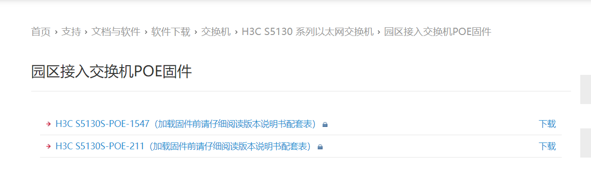

S5130-52S-PWR-EI poe固件在哪里下载
段
粉丝:人 关注:人
https://www.h3c.com/cn/d_202108/1455414_30005_40.htm#_Toc80836907https://www.h3c.com/cn/Service/Document_Software/Software_Download/Switches/Catalog/H3C_S5130/POE/?CHID=550662&v=612
