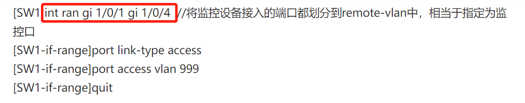

[SW1]int ran gi 1/0/1 gi 1/0/4  //将监控设备接入的端口都划分到remote-vlan中,相当于指定为监控口
[SW1-if-range]port link-type access
[SW1-if-range]port access vlan 999
[SW1-if-range]quit

如果这些端口已经配置了vlan 怎么处理
