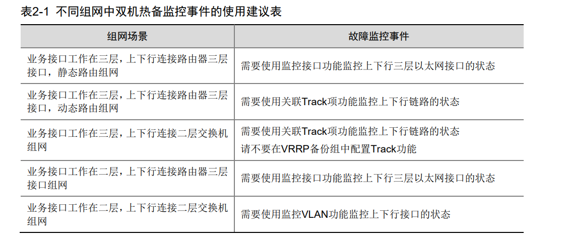

RBM(主备)+VRRP 配置后当track接口down时,VRRP状态不切换,是否是配置有问题
remote-backup group
 data-channel interface Ten-GigabitEthernet6/0/24
 delay-time 30
 track 1
local-ip 192.168.100.1
 remote-ip 192.168.100.2
 device-role primary
interface Vlan-interface80
 ip address 192.168.3.58 255.255.255.248
 vrrp vrid 8 virtual-ip 192.168.3.57
 vrrp vrid 8 priority 120
 vrrp vrid 8 track 1 switchover
 vrrp vrid 8 track 1 weight reduced 50
track 1 interface Ten-GigabitEthernet6/0/8
V-Ten-GigabitEthernet6/0/8]shutdown
V>dis vrrp
IPv4 Virtual Router Information:
 Running mode      : Standard
 RBM control channel is established
   VRRP active group status : Backup
   VRRP standby group status: Backup
 Total number of virtual routers : 8
 Interface          VRID  State        Running Adver   Auth     Virtual
                                       Pri     Timer   Type        IP
 Vlan80             8     Master       120     100     None     192.168.3.57
查看组状态是切换到Backup,但是下面详细vlan中的状态还是Master

联动vrrp后不用track接口
参考这个看看https://zhiliao.h3c.com/Theme/details/194611

图中有提到不建议Track

你好,这个图是在哪里可以找到?
