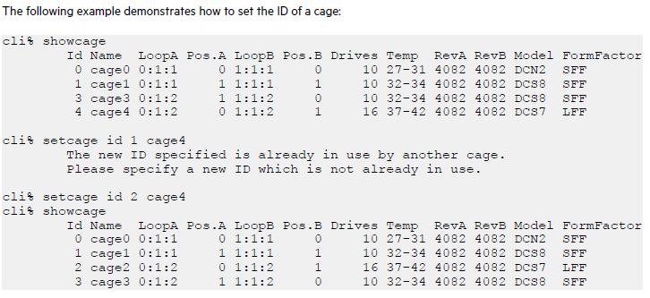

更换cage后id会发生变化,也可以改回原来的id,但有三种情况不能改。
The cage id cannot be changed if:
◦ There is an ongoing servicemag operation.
◦ There are LDs in the system created with the -cg parameter.
◦ There is a cage already using the specified ID.
