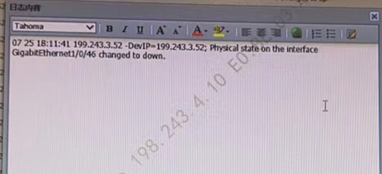

S5130设备产生的接口UP/DOWN的告警,完整告警内容为: *Jul 25 18:11:41:865 2022 100B4-A1-31U-0SUR5130 IFNET/3/PHY UPDONN: Physical state on the interface Gigabitkthernet1/0/27 changed to down.
但是监控平台收到的日志内容仅仅为Physical state on the interface Gigabitkthernet1/0/27 changed to down.,缺少100B4-A1-31U-0SUR5130 IFNET/3/PHY UPDONN:
这是为什么?
您好,正常得,因为监控平台是显示具体得告警信息得,前面不再加设备名称了
