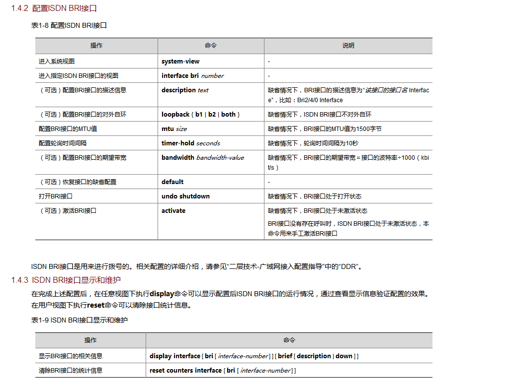

interface Serial6/0:15 ppp authentication-mode chap ppp chap user SHHX4700 dialer circular enable dialer-group 1 dialer timer idle 600 dialer route ip 20.133.10.50 mask 32 dial-number 33183449 user XTZZ ip address 30.133.10.3 255.255.255.0 我只翻到了这。。。。 [RT-2-Serial6/0:15]isdn ? bch-local-manage Set local ISDN B channel management bch-select-way Set ISDN B channel selection method caller-number Set an ISDN caller number calling Set an ISDN calling number carry Set ISDN L3 messages or fields carried check-called-number Filter digital calls by matching permitted called numbers and subaddresses crlength Set the ISDN call reference length ignore Set ISDN L3 messages or fields ignored l3-timer Set ISDN Layer 3 system timers link-mode Set the ISDN link layer mode number-property Set ISDN number type and numbering plan overlap-sending Set ISDN overlap-sending mode pri-slipwnd-size Set ISDN PRI Layer 2 sliding window size progress-indicator Set the progress indicator in ISDN signaling messages progress-to-alerting Converting PROGRESS messages to ALERTING messages protocol-mode Set ISDN protocol mode protocol-type Set ISDN protocol type for interface q921-permanent Enable Q.921 permanent link mode two-tei Negotiate a TEI for each ISDN BRI B-channel 看不懂阿啊啊啊啊
zhiliao_OGJRk 发表时间:2018-09-07
interface Serial6/0:15 ppp authentication-mode chap ppp chap user SHHX4700 dialer circular enable dialer-group 1 dialer timer idle 600 dialer route ip 20.133.10.50 mask 32 dial-number 33183449 user XTZZ ip address 30.133.10.3 255.255.255.0 我只翻到了这。。。。 [RT-2-Serial6/0:15]isdn ? bch-local-manage Set local ISDN B channel management bch-select-way Set ISDN B channel selection method caller-number Set an ISDN caller number calling Set an ISDN calling number carry Set ISDN L3 messages or fields carried check-called-number Filter digital calls by matching permitted called numbers and subaddresses crlength Set the ISDN call reference length ignore Set ISDN L3 messages or fields ignored l3-timer Set ISDN Layer 3 system timers link-mode Set the ISDN link layer mode number-property Set ISDN number type and numbering plan overlap-sending Set ISDN overlap-sending mode pri-slipwnd-size Set ISDN PRI Layer 2 sliding window size progress-indicator Set the progress indicator in ISDN signaling messa ges progress-to-alerting Converting PROGRESS messages to ALERTING me ssages protocol-mode Set ISDN protocol mode protocol-type Set ISDN protocol type for interface q921-permanent Enable Q.921 permanent link mode two-tei Negotiate a TEI for each ISDN BRI B-channel 看不懂阿啊啊啊啊
