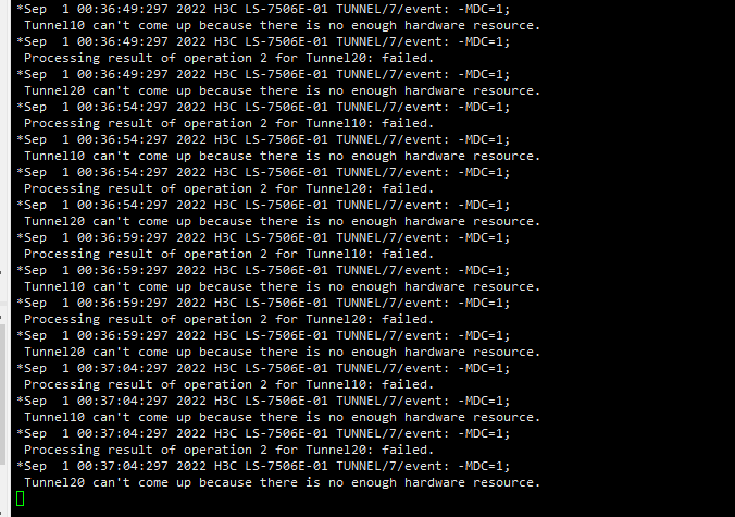

问题:H3C交换机无法建立GRE隧道,调试时提示如下信息,是否硬件不支持或需要lisence?还是配置的原因呢?
达到硬件限制了
有相关文档说明吗

请参考:
使用S7503E交换机搭建GRE VPN时,tunnel接口始终不UP。检查路由、配置等信息后全部正常。
<H3C>dis int brief
Brief information on interfaces in route mode:
Link: ADM - administratively down; Stby - standby
Protocol: (s) - spoofing
Interface            Link Protocol Primary IP      Description
NULL0                UP   UP(s)    --
Tun1                 DOWN DOWN     10.10.20.20
通过设备日志发现日志中有下面提示:
<H3C>*Jan  6 13:20:08:575 2017 H3C TUNNEL/7/event:
Processing result of operation 2 for Tunnel1: failed.
Tunnel1 can&#39;t come up because there is no enough hardware resource.
# 创建业务环回组1,并配置服务类型为Tunnel。
<SwitchA> system-view
[SwitchA] service-loopback group 1 type tunnel
# 将接口GigabitEthernet1/0/4加入业务环回组1。
[SwitchA] interface gigabitethernet 1/0/4
[SwitchA-GigabitEthernet1/0/4] port service-loopback group 1
[SwitchA-GigabitEthernet1/0/4] quit
在交换机中配置GRE时一定要将业务环回组加入到物理端口,只要有对应的接口资源后tunnel接口就会UP。
