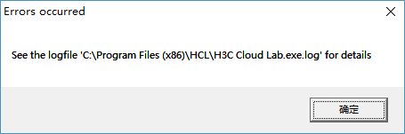

启动时弹出下面的对话框
2017-08-15_085205
查看H3C Cloud Lab.exe.log
Traceback (most recent call last):
  File "HCLUpdate.py", line 9, in <module>
  File "Ui_PopUp.pyc", line 10, in <module>
  File "PyQt4\QtGui.pyc", line 12, in <module>
  File "PyQt4\QtGui.pyc", line 10, in __load
ImportError: DLL load failed: 操作系统无法运行 %1。
之前是正常的,后来就成这样,是不是Win10升级的原因?
