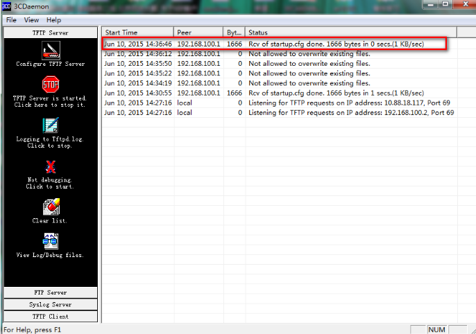

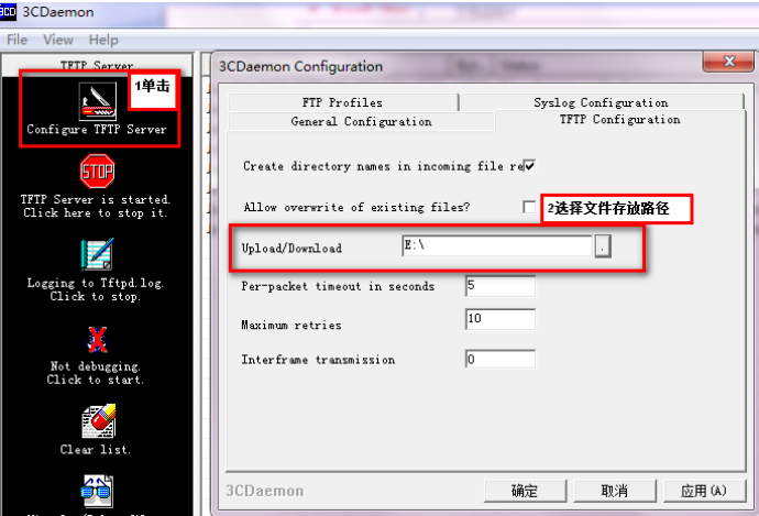

给设备和电脑配置成同网段IP地址(举例:WAC配置成192.168.100.1,电脑配置成192.168.100.2),在电脑上通过3CD软件搭建tftp服务器。
<H3C>sys
System View: return to User View with Ctrl+Z.
[H3C]interface Vlan-interface 1
[H3C-Vlan-interface1]ip address 192.168.100.1 24
[H3C-Vlan-interface1]quit
[H3C]ping 192.168.100.2
  PING 192.168.100.2: 56  data bytes, press CTRL_C to break
    Reply from 192.168.100.2: bytes=56 Sequence=1 ttl=128 time=7 ms
    Reply from 192.168.100.2: bytes=56 Sequence=2 ttl=128 time=2 ms
<H3C>tftp 192.168.100.2 put startup.cfg
  File will be transferred in binary mode
  Sending file to remote TFTP server. Please wait... |
  TFTP:     1666 bytes sent in 0 second(s).
  File uploaded successfully.
<H3C>
下载成功
可以到本地相关路径(此例子中是E盘)查看到相关文件。

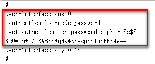

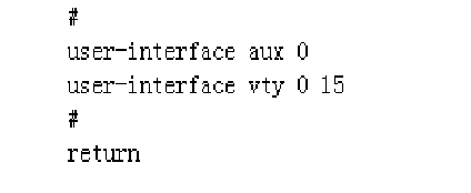

需要恢复之前配置
解决方法:删除密码恢复之前配置文件
使用记事本打开startup.cfg文件
删除aux0口下的认证方式和密码并保存文件
覆盖当前配置文件
<H3C>tftp 192.168.100.20 get startup.cfg
The file startup.cfg exists. Overwrite it? [Y/N]:y
  Verifying server file...
  Deleting the old file, please wait...
  Downloading file from remote TFTP server, please wait....
  TFTP:     1166 bytes received in 0 second(s)
  File downloaded successfully.
