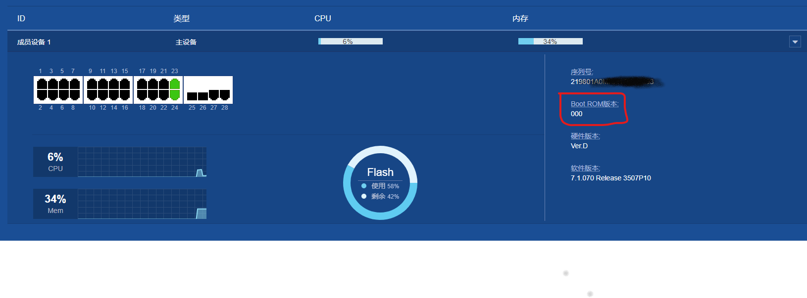

现在S5130-28TP-EI交换机无法通过BootROM加载boot/system bin文件,导致交换机无法运行。
通过将bin文件直接加载到SDRAM运行后,在Web管理页面中发现Boot ROM的版本显示为000。
Web中升级系统软件也提示“操作失败”
您好,检查下版本是否正常
****************************************************************************** * Copyright (c) 2004-2023 New H3C Technologies Co., Ltd. All rights reserved.* * Without the owner's prior written consent, * * no decompiling or reverse-engineering shall be allowed. * ****************************************************************************** <H3C> <H3C>%Jan 1 03:29:08:135 2013 H3C SHELL/5/SHELL_LOGIN: TTY logged in from aux0. <H3C>dis v <H3C>dis version H3C Comware Software, Version 7.1.070, Release 3507P10 Copyright (c) 2004-2023 New H3C Technologies Co., Ltd. All rights reserved. H3C S5130-28TP-EI uptime is 0 weeks, 0 days, 1 hour, 45 minutes Last reboot reason : User reboot Slot 1: Uptime is 0 weeks,0 days,1 hour,45 minutes S5130-28TP-EI with 1 Processor BOARD TYPE: S5130-28TP-EI DRAM: 1024M bytes FLASH: 512M bytes PCB 1 Version: VER.D Bootrom Version: 000 CPLD 1 Version: 001 Release Version: H3C S5130-28TP-EI-3507P10 Patch Version : None Reboot Cause : UserReboot [SubSlot 0] 24GE+2SFP-Plus+2XGT <H3C> 通过control线查看,Boot ROM版本也是000。 现在的系统是直接加载在SDRAM中的,不能重启,一旦重启就都没了。
