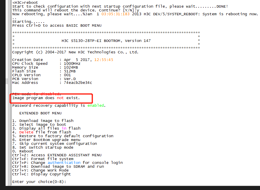

交换机重启就开不开机,bootrom版本 3个0,开机就进引导模式,ctrl+r 下载到sdram里运行才能开开,然后重启又进不去,求大佬支支招

1、你这个图片提示了镜像不存在了呀
2、 看第二张图提示的重新原因是warm reboot 重启的, warm reboot 表示未知原因导致的重启
你重新刷一下版本吧,版本下载地址,账号yx800 密码01230213,按照附录C指导去升级

但是里面是有系统的,重启他就是提示这个
zhiliao_aIyEPT 发表时间:2023-06-05
重启后你看我回复的图片红框中,提示没有image 呀

<H3C>reb
<H3C>reboot
Start to check configuration with next startup configuration file, please wait.........DONE!
This command will reboot the device. Continue? [Y/N]:y
Now rebooting, please wait....%Jan 1 00:01:47:533 2013 H3C DEV/5/SYSTEM_REBOOT: System is rebooting now.
Starting......
Press Ctrl+D to access BASIC BOOT MENU
* H3C S5130-28TP-EI BOOTROM, Version 147 *
Copyright (c) 2004-2017 New H3C Technologies Co., Ltd.
Creation Date : Apr 5 2017, 12:55:45
CPU Clock Speed : 1000MHz
Memory Size : 1024MB
Flash Size : 512MB
CPLD Version : 001
PCB Version : Ver.D
Mac Address : 74eacb2be34c
PEX mode is disabled.
Image program does not exist.
Password recovery capability is enabled.
EXTENDED BOOT MENU
1. Download image to flash
2. Select image to boot
3. Display all files in flash
4. Delete file from flash
5. Restore to factory default configuration
6. Enter BootRom upgrade menu
7. Skip current system configuration
8. Set switch startup mode
0. Reboot
Ctrl+Z: Access EXTENDED ASSISTANT MENU
Ctrl+F: Format file system
Ctrl+P: Change authentication for console login
Ctrl+R: Download image to SDRAM and run
Ctrl+Y: Change Work Mode
Ctrl+C: Display Copyright
Enter your choice(0-8):

里面本来是有系统的,我ctrl+r 下载到sdram里运行,然后就进入系统了,dis version bootrom版本 000 , boot-loader也是有系统的,dir也是有的 reboot后就起不来了
zhiliao_aIyEPT 发表时间:2023-06-05 更多>>
