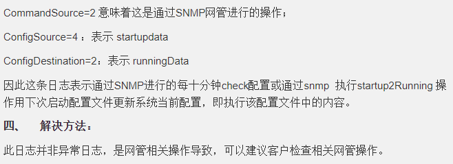

客户的防火墙每天都会产生如下日志:
FW2 CFGMAN/5/CFGMAN_CFGCHANGED: -EventIndex=1288-CommandSource=2-COnfigSource=3-COnfigDestination=2; Configuration is changed. %
 FW2 CFGMAN/5/CFGMAN_CFGCHANGED: -EventIndex=1289-CommandSource=2-COnfigSource=3-COnfigDestination=2; Configuration is changed. %
FW2 CFGMAN/5/CFGMAN_CFGCHANGED: -EventIndex=1290-CommandSource=2-COnfigSource=2-COnfigDestination=6; Configuration is changed. %
 FW2 CFGMAN/5/CFGMAN_CFGCOPY: -OptType=3-OptTime=372-OptState=2-OptEndTime=2335932728; Configuration is copied.
请问产生这些配置的原因是因为配置被修改了吗?如果没有被修改会弹出那些日志吗?

内网应该是有网管系统,例如:zabbix,或者其他监控设备的平台
