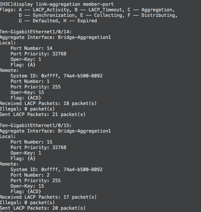

交换机的配置
interface Bridge-Aggregation1
port link-type trunk
undo port trunk permit vlan 1
port trunk permit vlan 2 to 4094
 port trunk pvid vlan 103
 link-aggregation mode dynamic
 lacp edge-port
interface Ten-GigabitEthernet1/0/14
port link-aggregation group 1
interface Ten-GigabitEthernet1/0/15

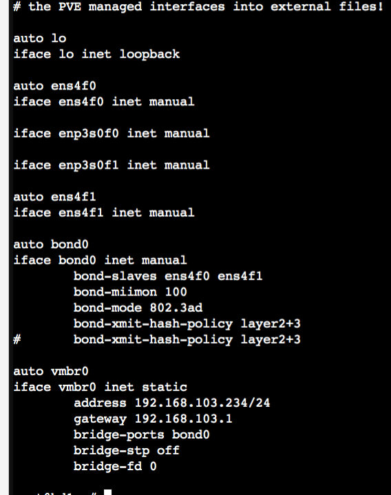

服务器的配置也没问题

物理接口下配置要和聚合口下一致
zhiliao_KWdnI6 知了小白
物理接口也要配置一遍port link-type trunk 吗?
