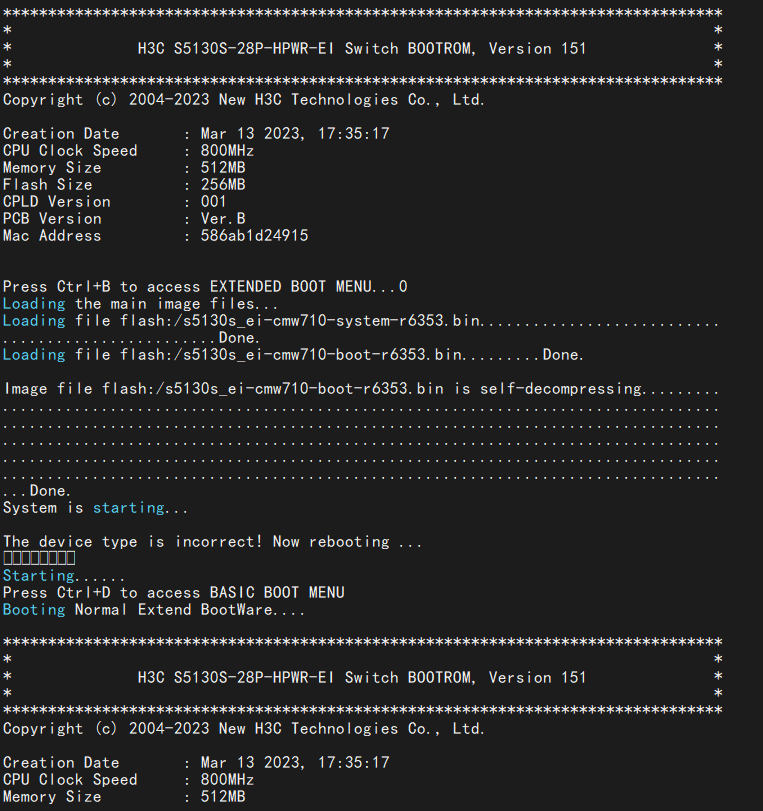

H3C S5130S-28P-HPWR-EI 升级版本提示型号错误,无法恢复出厂设置
2023-08-10提问
  • 0收藏,2316浏览
升级版本后,提示型号错误,恢复出厂设置报错

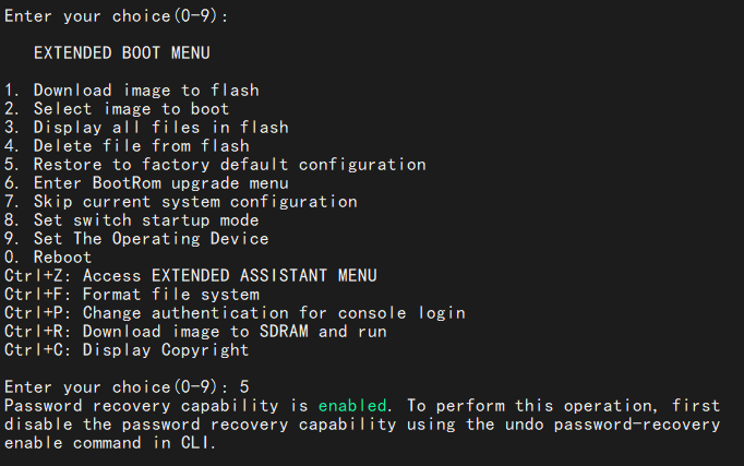

恢复出厂试下这个
V7交换机bootrom恢复出厂配置

 #当显示信息出现“Press Ctrl+B to access EXTENDED BOOT MENU...”时,键入<Ctrl+B>,系统将进入扩展BootRom主菜单。如果没有及时键入<Ctrl+B>需要重启设备重复之前操作。
Press Ctrl+B to access EXTENDED BOOT MENU...0
Password recovery capability is enabled.
注:当出现提示“Password recovery capability is enabled.”说明密码恢复功能开启。
密码恢复功能开启时,用户可以使用扩展BootRom菜单中除选项5以外的所有菜单项,选择7恢复出厂;
密码恢复功能关闭时,不支持选择7,选择5恢复出厂;
   EXTENDED BOOT MENU
1. Download image to flash
2. Select image to boot
3. Display all files in flash
4. Delete file from flash
5. Restore to factory default configuration
6. Enter BootRom upgrade menu
7. Skip current system configuration
8. Set switch startup mode
9. Set The Operating Device
0. Reboot
Ctrl+Z: Access EXTENDED ASSISTANT MENU
Ctrl+F: Format file system
Ctrl+P: Change authentication for console login
Ctrl+R: Download image to SDRAM and run
Ctrl+C: Display Copyright
Enter your choice(0-9): 7          //由于设备密码恢复功能开启,此处选择7
The current setting will run with current configuration file when reboot.
Are you sure you want to skip current configuration file when reboot? Yes or No
(Y/N):Y    //选择Y跳过当前配置文件重启
Setting...Done.

输入7,在输入Y,再输入0,之后还是提示The device type is incorrect! Now rebooting ...请问如何解决
zhiliao_WGQanS 发表时间:2023-08-11 更多>>

设备异常,请联系400热线寻求帮助。
