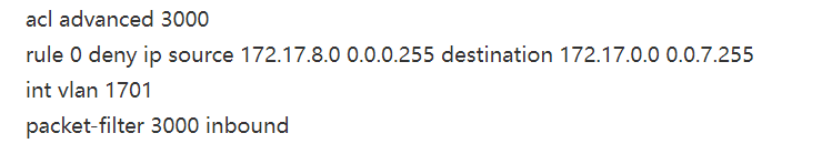

核心交换机:
acl advanced 3000
rule 0 deny ip source 172.17.8.0 0.0.0.255 destination 172.17.0.0 0.0.7.255
int vlan 1701
packet-filter 3000 inbound

ACL默认最后一个rule就是拒绝。你这么写是全不通。在intvlan1701下,应该是outbound
