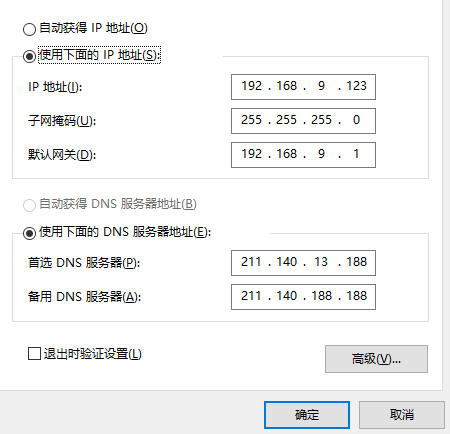

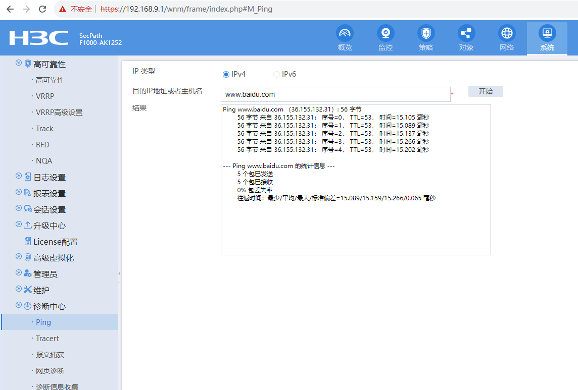

H3C F1000-AK1252配置问题,内网电脑无法上外网,请问哪里配置不对?

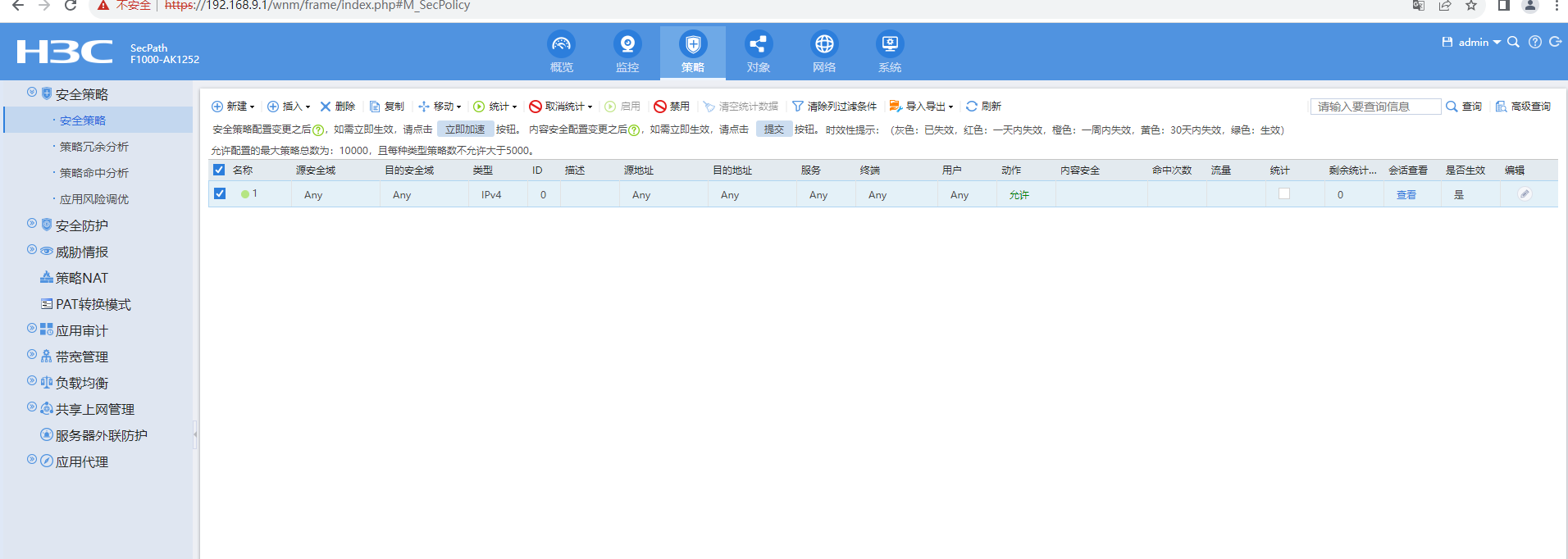

nat 策略没有配置
命令行方式:
int g1/0/2
 nat outbound
配置了也不行
zhiliao_sw2qVx 发表时间:2023-08-29 更多>>
配置了也不行

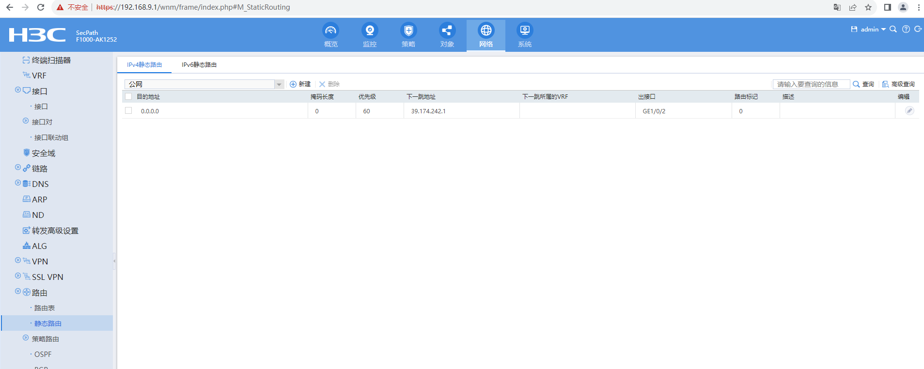

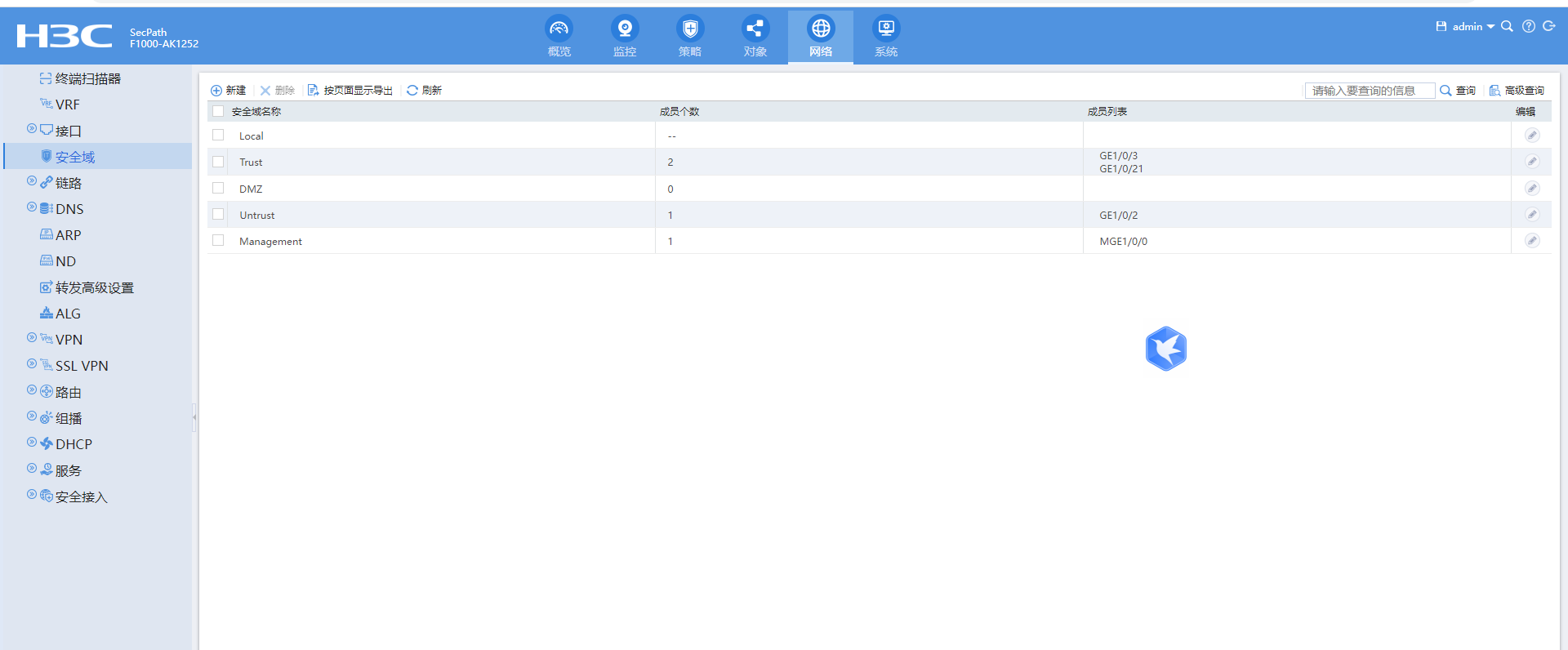

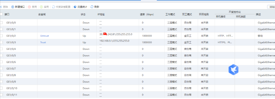

把配置文件提供下
[H3C-GigabitEthernet1/0/2]dis cur # version 7.1.064, Release 8860P18 # sysname H3C # clock protocol none # context Admin id 1 # irf mac-address persistent timer irf auto-update enable undo irf link-delay irf member 1 priority 1 # dns server 211.140.13.188 dns server 211.140.188.188 # password-recovery enable # vlan 1 # interface NULL0 # interface GigabitEthernet1/0/0 port link-mode route # interface GigabitEthernet1/0/1 port link-mode route # interface GigabitEthernet1/0/2 port link-mode route description 移动 ip address 39.174.242.81 255.255.255.0 nat outbound manage http inbound manage https inbound manage ping inbound manage snmp inbound manage ssh inbound manage telnet inbound # interface GigabitEthernet1/0/3 port link-mode route ip address 192.168.9.1 255.255.255.0 manage https inbound manage ping inbound manage telnet inbound manage telnet outbound # interface GigabitEthernet1/0/4 port link-mode route # interface GigabitEthernet1/0/5 port link-mode route # interface GigabitEthernet1/0/6 port link-mode route # interface GigabitEthernet1/0/7 port link-mode route # interface GigabitEthernet1/0/8 port link-mode route # interface GigabitEthernet1/0/9 port link-mode route # interface GigabitEthernet1/0/10 port link-mode route # interface GigabitEthernet1/0/11 port link-mode route # interface GigabitEthernet1/0/12 port link-mode route # interface GigabitEthernet1/0/13 port link-mode route # interface GigabitEthernet1/0/14 port link-mode route # interface GigabitEthernet1/0/15 port link-mode route # interface GigabitEthernet1/0/16 port link-mode route combo enable fiber # interface GigabitEthernet1/0/17 port link-mode route combo enable fiber # interface GigabitEthernet1/0/18 port link-mode route combo enable fiber # interface GigabitEthernet1/0/19 port link-mode route combo enable fiber # interface GigabitEthernet1/0/20 port link-mode route # interface GigabitEthernet1/0/21 port link-mode route description 内网 ip address 192.168.8.254 255.255.255.0 ip last-hop hold manage http inbound manage https inbound manage ping inbound manage snmp inbound manage ssh inbound manage telnet inbound # interface GigabitEthernet1/0/22 port link-mode route # interface GigabitEthernet1/0/23 port link-mode route # interface GigabitEthernet1/0/24 port link-mode route # interface GigabitEthernet1/0/25 port link-mode route # interface M-GigabitEthernet1/0/0 ip address 192.168.0.1 255.255.255.0 # interface Ten-GigabitEthernet1/0/26 port link-mode route manage https inbound manage ping inbound manage snmp inbound manage ssh inbound manage telnet inbound # interface Ten-GigabitEthernet1/0/27 port link-mode route # security-zone name Local # security-zone name Trust import interface GigabitEthernet1/0/3 import interface GigabitEthernet1/0/21 # security-zone name DMZ # security-zone name Untrust import interface GigabitEthernet1/0/2 # security-zone name Management import interface M-GigabitEthernet1/0/0 # scheduler logfile size 16 # line class console authentication-mode scheme user-role network-admin # line class vty user-role network-operator # line con 0 user-role network-admin # line vty 0 63 authentication-mode scheme user-role network-admin # ip route-static 0.0.0.0 0 39.174.242.1 # info-center loghost 127.0.0.1 port 3301 format default info-center loghost 192.168.8.3 format default info-center source CFGLOG loghost level informational # customlog host 192.168.8.3 export session security-policy dpi ips anti-virus # performance-management # ssh server enable # domain system # domain default enable system # role name level-0 description Predefined level-0 role # role name level-1 description Predefined level-1 role # role name level-2 description Predefined level-2 role # role name level-3 description Predefined level-3 role # role name level-4 description Predefined level-4 role # role name level-5 description Predefined level-5 role # role name level-6 description Predefined level-6 role # role name level-7 description Predefined level-7 role # role name level-8 description Predefined level-8 role # role name level-9 description Predefined level-9 role # role name level-10 description Predefined level-10 role # role name level-11 description Predefined level-11 role # role name level-12 description Predefined level-12 role # role name level-13 description Predefined level-13 role # role name level-14 description Predefined level-14 role # user-group system # local-user admin class manage password hash $h$6$W47fqCetf5OYU70O$DrSWFmB9c5XslLk39jxT68QjCxlGVqSp4JaNbuekggqteXgYNoSLfRsRPpE2oz9QPrVBz7v5LtJ0vTxjGkzbXw== service-type ssh terminal https authorization-attribute user-role level-3 authorization-attribute user-role network-admin authorization-attribute user-role network-operator # ipsec logging negotiation enable # nat global-policy rule name GlobalPolicyRule_2 action snat no-nat # ike logging negotiation enable # ip http enable ip https enable # blacklist global enable # inspect email parameter-profile mailsetting_default_parameter undo authentication enable # loadbalance isp file flash:/lbispinfo_v1.5.tp # security-policy ip rule 0 name 1 action pass # ips policy 拒接 object-dir server client action drop severity-level medium high critical status enabled protect-target ApplicationSoftware IM protect-target ApplicationSoftware MailClient protect-target Browser InternetExplorer protect-target Database ACCESS protect-target Database MS-SQL protect-target Database MySQL protect-target Database Oracle protect-target Database Other protect-target FTPServer Any protect-target MailServer LotusNotes protect-target NetworkDevice Cisco protect-target NetworkProtocol FTP protect-target NetworkProtocol HTTP protect-target NetworkProtocol TELNET protect-target OfficeSoftware MicrosoftOffice protect-target Other Other protect-target WebApplication Any protect-target WebApplication Blog protect-target WebApplication CMS protect-target WebApplication JSP protect-target WebApplication Other protect-target WebApplication PHP protect-target WebServer Any protect-target WebServer Other protect-target WebServer WebLogic attack-category Other Other attack-category Vulnerability SQLInjection attack-category Vulnerability XSS # anti-virus policy av undo inspect smtp inspect imap direction download action alert # cloud-management server domain opstunnel-seccloud.h3c.com # return [H3C-GigabitEthernet1/0/2
