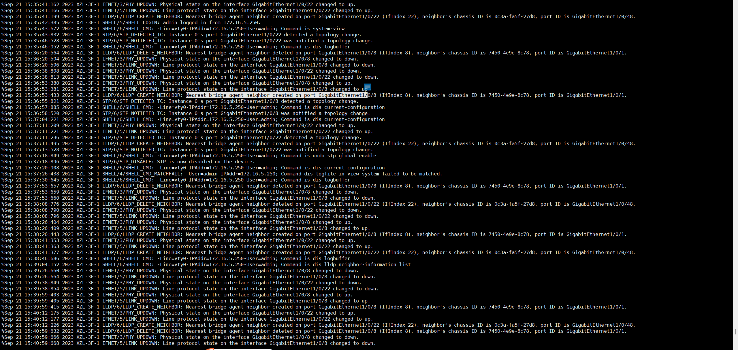

S5130S交换机出现下面这个日志,网络时断时续,反复出现这个日志
%Sep 21 15:45:38:664 2023 XZL-3F-1 IFNET/3/PHY_UPDOWN: Physical state on the interface GigabitEthernet1/0/8 changed to down. %Sep 21 15:45:38:668 2023 XZL-3F-1 IFNET/5/LINK_UPDOWN: Line protocol state on the interface GigabitEthernet1/0/8 changed to down. %Sep 21 15:45:38:775 2023 XZL-3F-1 LLDP/6/LLDP_DELETE_NEIGHBOR: Nearest bridge agent neighbor deleted on port GigabitEthernet1/0/22 (IfIndex 22), neighbor's chassis ID is 0c3a-fa5f-27d8, port ID is GigabitEthernet1/0/48. %Sep 21 15:45:38:792 2023 XZL-3F-1 IFNET/3/PHY_UPDOWN: Physical state on the interface GigabitEthernet1/0/22 changed to down. %Sep 21 15:45:38:793 2023 XZL-3F-1 IFNET/5/LINK_UPDOWN: Line protocol state on the interface GigabitEthernet1/0/22 changed to down.
