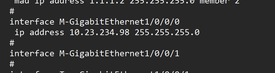

两台S7506X-S 做完IRF后 只看到主设备上的2个M-GigabitEthernet口 没法配置从设备上的带外管理口
如果两台设备发生了分裂 从设备没法带外管理

# vlan 999 # irf-port 1/2 port group interface Ten-GigabitEthernet1/0/0/23 mode enhanced port group interface Ten-GigabitEthernet1/0/0/24 mode enhanced port group interface Ten-GigabitEthernet1/1/0/23 mode enhanced port group interface Ten-GigabitEthernet1/1/0/24 mode enhanced # irf-port 2/1 port group interface Ten-GigabitEthernet2/0/0/23 mode enhanced port group interface Ten-GigabitEthernet2/0/0/24 mode enhanced port group interface Ten-GigabitEthernet2/1/0/23 mode enhanced port group interface Ten-GigabitEthernet2/1/0/24 mode enhanced # stp global enable # ftth # interface NULL0 # interface Vlan-interface999 mad bfd enable mad ip address 1.1.1.1 255.255.255.0 member 1 mad ip address 1.1.1.2 255.255.255.0 member 2 # interface M-GigabitEthernet1/0/0/0 ip address 10.23.234.98 255.255.255.0 # interface M-GigabitEthernet1/0/0/1 #

堆叠是成功的 现在的问题是 如果分裂了 我没法远程带外管理从设备 从设备上带外口没法配置

irf做了 bfd检测也做了 我的意思是想在从设备上也接一根带外管理 以便于分裂后 我登录不上从设备 我现在做完irf没法配置从设备的带外管理 只有两个主设备上的带外管理口
