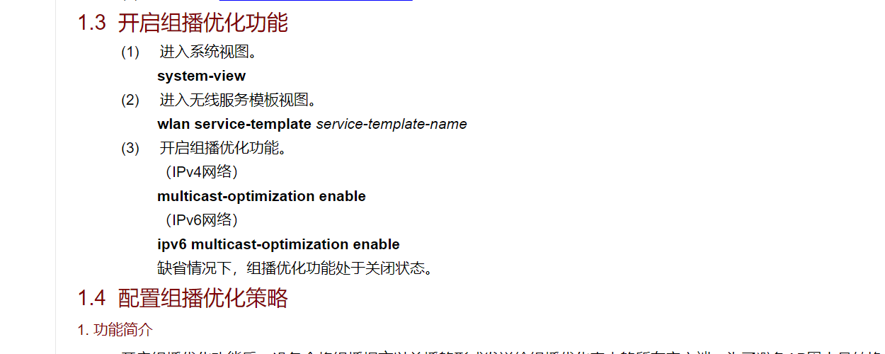

如图:
链接:https://www.h3c.com/cn/d_202212/1737683_30005_0.htm#_Toc120367185
