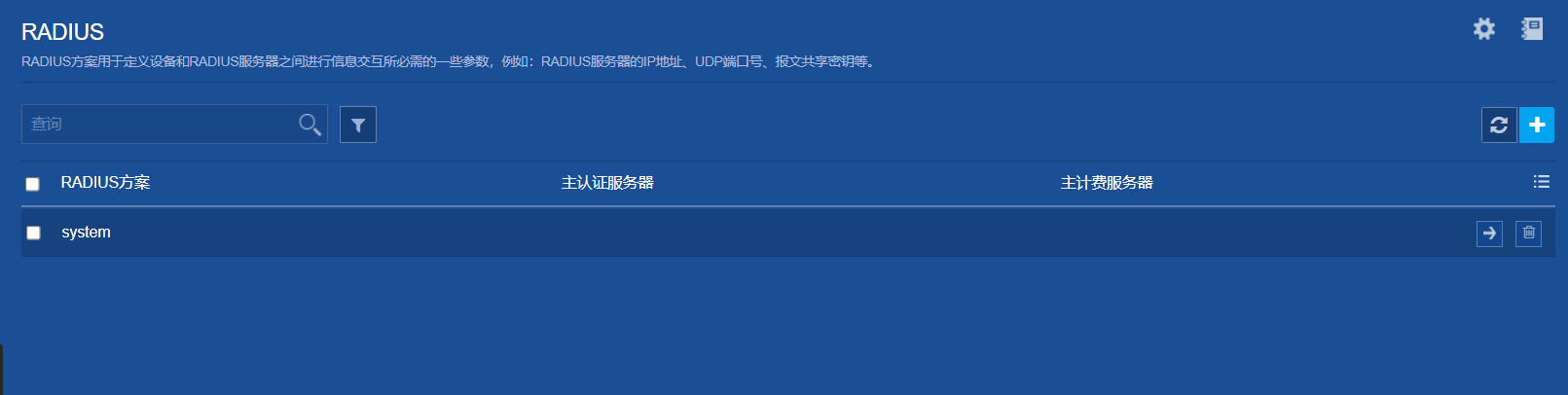

请问这个本地域system,需要点进去配置些什么吗? 我想用MAC认证,用本地的RADIUS服务
本地不需要配置这个,参考案例
1.32.1 本地MAC地址认证配置举例

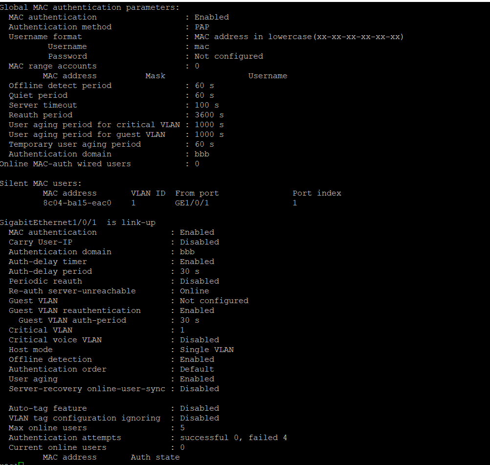

请问为什么这样,认证失败后,日志里面没有认证失败的内容呢?
zhiliao_9qpPKw 发表时间:2023-11-16
会有的,dis log 找一下
zhiliao_sEUyB 发表时间:2023-11-16
2013-01-01 05:05:54 NotificationLine protocol state on the interface GigabitEthernet1/0/1 changed to up. 2013-01-01 05:05:54 ErrorPhysical state on the interface GigabitEthernet1/0/1 changed to up. 2013-01-01 05:05:49 NotificationLine protocol state on the interface GigabitEthernet1/0/1 changed to down. 2013-01-01 05:05:49 ErrorPhysical state on the interface GigabitEthernet1/0/1 changed to down. 2013-01-01 05:05:28 Informational-Line=aux0-IPAddr=**-User=**; Command is display mac-authentication 试了几次都是这样,只有display mac-auth里面的 authentication attempts failed 每次+1
没用认证的记录啊
zhiliao_9qpPKw 知了小白
您说的方法我试过了,但是我发现log里面没有认证失败,甚至直接准入了。
