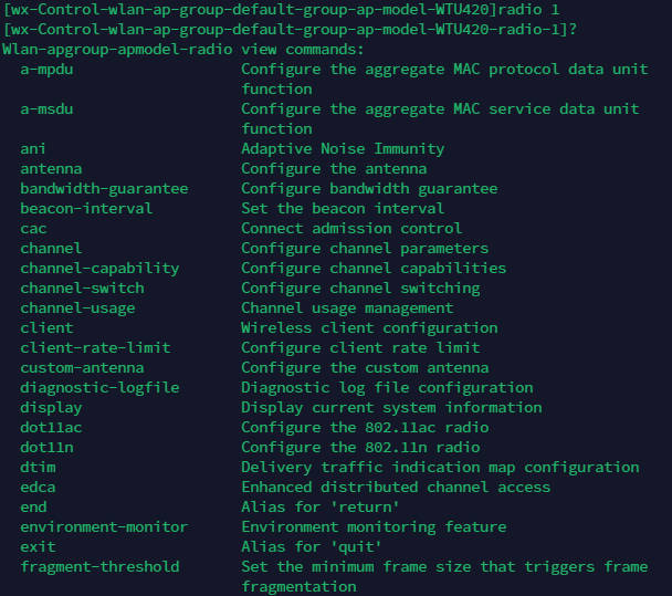

但是在配置里面没有client-proximity-sensor enable这条开启命令,是在其他位置嘛 [wx-Control-wlan-ap-group-default-group-ap-model-WTU420]radio 1 [wx-Control-wlan-ap-group-default-group-ap-model-WTU420-radio-1]? Wlan-apgroup-apmodel-radio view commands: a-mpdu Configure the aggregate MAC protocol data unit function a-msdu Configure the aggregate MAC service data unit function ani Adaptive Noise Immunity antenna Configure the antenna bandwidth-guarantee Configure bandwidth guarantee beacon-interval Set the beacon interval cac Connect admission control channel Configure channel parameters channel-capability Configure channel capabilities channel-switch Configure channel switching channel-usage Channel usage management client Wireless client configuration client-rate-limit Configure client rate limit custom-antenna Configure the custom antenna diagnostic-logfile Diagnostic log file configuration display Display current system information dot11ac Configure the 802.11ac radio dot11n Configure the 802.11n radio dtim Delivery traffic indication map configuration edca Enhanced distributed channel access end Alias for 'return' environment-monitor Environment monitoring feature exit Alias for 'quit' fragment-threshold Set the minimum frame size that triggers frame fragmentation green-energy-management Green Energy Management ldpc Configure the Low Density Parity Check Code function. lock Lock the current line logfile Log file configuration long-retry Configure the system to retransmit frames that exceed the RTS threshold max-power Set the maximum transmit power max-rx-duration Set the maximum time that a received frame can stay in the buffer measure Configure measurement functions measure-duration Set the measurement duration measure-interval Set the measurement interval mimo Multi-input Multi-output monitor System monitor mu-txbf Configure Multi-User Tx Beamforming function no Alias for 'undo' option WLAN optimization ping Ping function power-capability Configure power capabilities power-constraint Configure power constraint power-lock Configure the power protection-threshold Set the minimum frame size that triggers protection quit Exit from current command view radar-detect radar detect feature radio Specify a radio by its ID rate Configure rate parameters repeat Repeat executing history commands reset Reset operation return Exit to User View rfid-tracking Wireless location feature rm-capability Configure radio measurement capability check roam-enhance Enable roaming enhancement rrop Optimization policy for radio resources sacp Station Access Control Policy save Save current configuration scan Channel scanning configuration security-logfile Security log file configuration service-template Bind a service template to the radio short-gi Configure the short guard interval function short-retry Configure the system to retransmit frames that within the RTS threshold show Alias for 'display' stbc Configure Space-Time Block Coding function su-txbf Configure Single-User Tx Beamforming function svp SpectraLink Voice Priority tracert Tracert function type Specify a radio type undo Cancel current setting wlan WLAN configuration wmm Wi-Fi multimedia function write Alias for 'save'

回复zhiliao_sEUyB:
型号是WX3510H,文档也查过,文档中的开启方式就是在radio视图下面输入client-proximity-sensor enable,但实际就是到radio 1 视图下面后没有开启的那条命令
zhiliao_w96HqG 发表时间:2024-01-10
试试其他型号 ap可以输入么
zhiliao_sEUyB 发表时间:2024-01-10
回复zhiliao_sEUyB:
有这条命令,是不是说就是AP不支持?
那就是了
回复zhiliao_sEUyB:
好吧,谢谢
