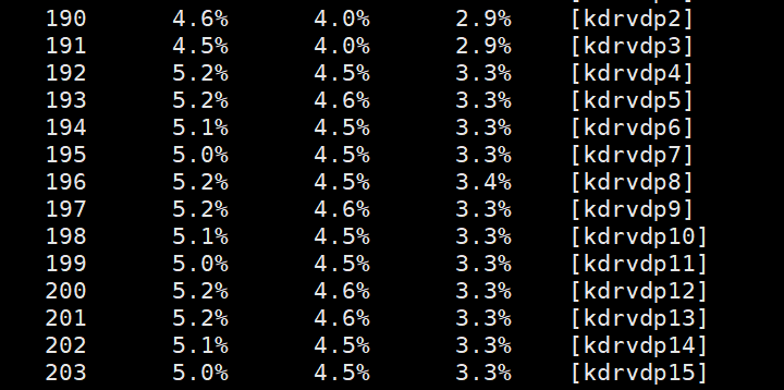

你好,根据命令,先排查job 190 ,如下显示 [fx-yzm-fw1080-probe]follow job 190 slot 1 Attaching to process 190 ([kdrvdp2]) Iteration 1 of 5 ------------------------------ Kernel stack: [<ffffffff804aa884>] schedule+0x6c4/0x1000 [<ffffffffe007e3f8>] F1000_WaitPkt+0x98/0xd0 [system] [<ffffffffe008490c>] work_f1000_RxRngMsg+0x7c/0xda0 [system] [<ffffffff80267bc0>] kthread+0x140/0x150 [<ffffffff8021c600>] kernel_thread_helper+0x10/0x20 Iteration 2 of 5 ------------------------------ Kernel stack: [<ffffffff804aa884>] schedule+0x6c4/0x1000 [<ffffffffe007e3e8>] F1000_WaitPkt+0x88/0xd0 [system] [<ffffffffe008490c>] work_f1000_RxRngMsg+0x7c/0xda0 [system] [<ffffffff80267bc0>] kthread+0x140/0x150 [<ffffffff8021c600>] kernel_thread_helper+0x10/0x20 Iteration 3 of 5 ------------------------------ Kernel stack: [<ffffffff804aa884>] schedule+0x6c4/0x1000 [<ffffffffe007e3e8>] F1000_WaitPkt+0x88/0xd0 [system] [<ffffffffe0084f04>] work_f1000_RxRngMsg+0x674/0xda0 [system] [<ffffffff80267bc0>] kthread+0x140/0x150 [<ffffffff8021c600>] kernel_thread_helper+0x10/0x20 Iteration 4 of 5 ------------------------------ Kernel stack: [fx-yzm-fw1080-probe]follow job 190 slot 1 Attaching to process 190 ([kdrvdp2]) Iteration 1 of 5 ------------------------------ Kernel stack: [<ffffffff804aa884>] schedule+0x6c4/0x1000 Iteration 2 of 5 ------------------------------ Kernel stack: [<ffffffff804aa884>] schedule+0x6c4/0x1000 [<ffffffffe007e3e8>] F1000_WaitPkt+0x88/0xd0 [system] [<ffffffffe0084f04>] work_f1000_RxRngMsg+0x674/0xda0 [system] [<ffffffff80267bc0>] kthread+0x140/0x150 [<ffffffff8021c600>] kernel_thread_helper+0x10/0x20 Iteration 3 of 5 ------------------------------ Kernel stack: [<ffffffff804aa884>] schedule+0x6c4/0x1000 Iteration 4 of 5 ------------------------------ Kernel stack: [<ffffffff804aa884>] schedule+0x6c4/0x1000 Iteration 5 of 5 ------------------------------ Kernel stack: [<ffffffff804aa884>] schedule+0x6c4/0x1000

感谢,根据命令显示job 190 ,帮忙分析下谢谢了 [fx-yzm-fw1080-probe]follow job 190 slot 1 Attaching to process 190 ([kdrvdp2]) Iteration 1 of 5 ------------------------------ Kernel stack: [<ffffffff804aa884>] schedule+0x6c4/0x1000 [<ffffffffe007e3f8>] F1000_WaitPkt+0x98/0xd0 [system] [<ffffffffe008490c>] work_f1000_RxRngMsg+0x7c/0xda0 [system] [<ffffffff80267bc0>] kthread+0x140/0x150 [<ffffffff8021c600>] kernel_thread_helper+0x10/0x20 Iteration 2 of 5 ------------------------------ Kernel stack: [<ffffffff804aa884>] schedule+0x6c4/0x1000 [<ffffffffe007e3e8>] F1000_WaitPkt+0x88/0xd0 [system] [<ffffffffe008490c>] work_f1000_RxRngMsg+0x7c/0xda0 [system] [<ffffffff80267bc0>] kthread+0x140/0x150 [<ffffffff8021c600>] kernel_thread_helper+0x10/0x20 Iteration 3 of 5 ------------------------------ Kernel stack: [<ffffffff804aa884>] schedule+0x6c4/0x1000 [<ffffffffe007e3e8>] F1000_WaitPkt+0x88/0xd0 [system] [<ffffffffe0084f04>] work_f1000_RxRngMsg+0x674/0xda0 [system] [<ffffffff80267bc0>] kthread+0x140/0x150 [<ffffffff8021c600>] kernel_thread_helper+0x10/0x20 Iteration 4 of 5 ------------------------------ Kernel stack: [fx-yzm-fw1080-probe]follow job 190 slot 1 Attaching to process 190 ([kdrvdp2]) Iteration 1 of 5 ------------------------------ Kernel stack: [<ffffffff804aa884>] schedule+0x6c4/0x1000 Iteration 2 of 5 ------------------------------ Kernel stack: [<ffffffff804aa884>] schedule+0x6c4/0x1000 [<ffffffffe007e3e8>] F1000_WaitPkt+0x88/0xd0 [system] [<ffffffffe0084f04>] work_f1000_RxRngMsg+0x674/0xda0 [system] [<ffffffff80267bc0>] kthread+0x140/0x150 [<ffffffff8021c600>] kernel_thread_helper+0x10/0x20 Iteration 3 of 5 ------------------------------ Kernel stack: [<ffffffff804aa884>] schedule+0x6c4/0x1000 Iteration 4 of 5 ------------------------------ Kernel stack: [<ffffffff804aa884>] schedule+0x6c4/0x1000 Iteration 5 of 5 ------------------------------ Kernel stack: [<ffffffff804aa884>] schedule+0x6c4/0x1000

谢谢大家,根据命令显示了几个进程占用cpu,帮忙分析下,感谢
