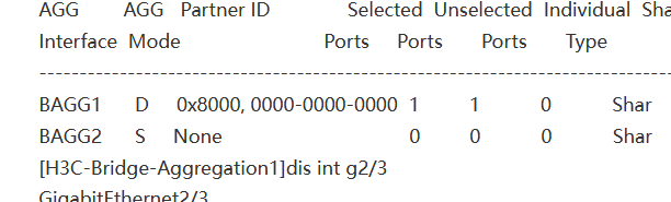

S1208V-HPWR交换机,选择聚合端口模式上接MER8300,配置动态聚合只有一个端口生效。

动态聚合配置如下:
AGG        AGG   Partner ID              Selected  Unselected  Individual  Share
Interface  Mode                          Ports     Ports       Ports       Type
BAGG1      D     0x8000, 0000-0000-0000  1         1           0           Shar
BAGG2      S     None                                  0         0           0           Shar
[H3C-Bridge-Aggregation1]dis int g2/3
GigabitEthernet2/3
Current state: UP
Line protocol state: DOWN(LAGG)
IP packet frame type: Ethernet II, hardware address: xxxxxxx
Description: GigabitEthernet2/3 Interface
Bandwidth: 1000000 kbps
Loopback is not set
Media type is twisted pair, port hardware type is 1000_BASE_T
1000Mbps-speed mode, full-duplex mode
Link speed type is autonegotiation, link duplex type is autonegotiation
Flow-control is not enabled
Maximum frame length: 10240
Allow jumbo frames to pass
Broadcast max-ratio: 100%
Multicast max-ratio: 100%
Unicast max-ratio: 100%
PVID: 1
MDI type: Automdix
Port link-type: Trunk
 VLAN Passing:   1(default vlan), 2
 VLAN permitted: 1(default vlan), 2-4094
 Trunk port encapsulation: IEEE 802.1q
Port priority: 0
配置在静态聚合BAGG2,两个端口都能起来,但是只有一边有流量。

<H3C>dis link-aggregation verbose Loadsharing Type: Shar -- Loadsharing, NonS -- Non-Loadsharing Port Status: S -- Selected, U -- Unselected, I -- Individual Port: A -- Auto port Flags: A -- LACP_Activity, B -- LACP_Timeout, C -- Aggregation, D -- Synchronization, E -- Collecting, F -- Distributing, G -- Defaulted, H -- Expired Aggregate Interface: Bridge-Aggregation1 Creation Mode: Manual Aggregation Mode: Dynamic Loadsharing Type: Shar System ID: 0x8000, xxxxxxxxxxx Local: Port Status Priority Oper-Key Flag -------------------------------------------------------------------------------- GE2/2 S 32768 1 {ACDEFG} GE2/3 U 32768 1 {ACG} Remote: Actor Partner Priority Oper-Key SystemID Flag -------------------------------------------------------------------------------- GE2/2 0 32768 0 0x8000, 0000-0000-0000 {DEF} GE2/3 0 32768 0 0x8000, 0000-0000-0000 {DEF}

动态聚合选中不了说明lacp报文交互有问题,查查链路有问题吗

动态肯定是起不来,因为傻瓜交换不支持lacp,两个聚合不影响

这个。。。多建一个聚合放着不用,不影响另一个聚合性能吧? 我建一个静态聚合是用来做对比的,配置静态聚合里面,能起来;同样的端口放在动态聚合里面起不来。
