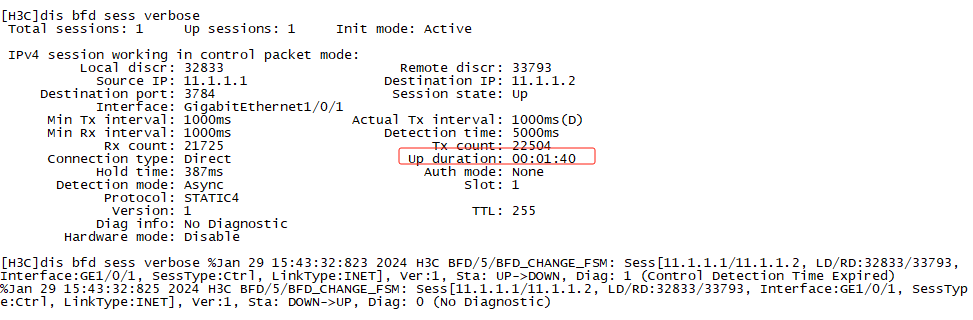

A1\B1为主链路,A2\B2为备用链路。192.168.168.10和192.168.169.10 到10.10.10.1 有两条链路,中间防火墙为透明模式,策略全通状态。为什么建立好的BFD会话状态会不断的切换?默认配置BFD ,两端设备的Holdtime 时间为什么不一样?
<H3C>%Jan 29 09:59:24:542 2024 H3C BFD/5/BFD_CHANGE_FSM: Sess[21.1.1.2/21.1.1.1, LD/RD:33794/32833, Interface:GE1/0/8, SessType:Ctrl, LinkType:INET], Ver:1, Sta: DOWN->INIT, Diag: 0 (No Diagnostic), Applications: STATIC4
%Jan 29 09:59:24:543 2024 H3C BFD/4/BFD_CHANGE_FSM: Sess[21.1.1.2/21.1.1.1, LD/RD:33794/32833, Interface:GE1/0/8, SessType:Ctrl, LinkType:INET], Ver:1, Sta: INIT->UP, Diag: 0 (No Diagnostic), Applications: STATIC4
%Jan 29 09:59:45:845 2024 H3C BFD/5/BFD_CHANGE_FSM: Sess[11.1.1.2/11.1.1.1, LD/RD:33793/32833, Interface:GE1/0/0, SessType:Ctrl, LinkType:INET], Ver:1, Sta: DOWN->INIT, Diag: 0 (No Diagnostic), Applications: STATIC4
%Jan 29 09:59:45:846 2024 H3C BFD/4/BFD_CHANGE_FSM: Sess[11.1.1.2/11.1.1.1, LD/RD:33793/32833, Interface:GE1/0/0, SessType:Ctrl, LinkType:INET], Ver:1, Sta: INIT->UP, Diag: 0 (No Diagnostic), Applications: STATIC4
%Jan 29 10:01:08:642 2024 H3C BFD/5/BFD_CHANGE_FSM: Sess[21.1.1.2/21.1.1.1, LD/RD:33794/32833, Interface:GE1/0/8, SessType:Ctrl, LinkType:INET], Ver:1, Sta: DOWN->INIT, Diag: 0 (No Diagnostic), Applications: STATIC4
%Jan 29 10:01:08:644 2024 H3C BFD/4/BFD_CHANGE_FSM: Sess[21.1.1.2/21.1.1.1, LD/RD:33794/32833, Interface:GE1/0/8, SessType:Ctrl, LinkType:INET], Ver:1, Sta: INIT->UP, Diag: 0 (No Diagnostic), Applications: STATIC4
%Jan 29 10:01:30:143 2024 H3C BFD/5/BFD_CHANGE_FSM: Sess[11.1.1.2/11.1.1.1, LD/RD:33793/32833, Interface:GE1/0/0, SessType:Ctrl, LinkType:INET], Ver:1, Sta: DOWN->INIT, Diag: 0 (No Diagnostic), Applications: STATIC4
%Jan 29 10:01:30:144 2024 H3C BFD/4/BFD_CHANGE_FSM: Sess[11.1.1.2/11.1.1.1, LD/RD:33793/32833, Interface:GE1/0/0, SessType:Ctrl, LinkType:INET], Ver:1, Sta: INIT->UP, Diag: 0 (No Diagnostic), Applications: STATIC4
<H3C>%Jan 29 09:59:02:330 2024 H3C BFD/5/BFD_CHANGE_FSM: Sess[11.1.1.1/11.1.1.2, LD/RD:32833/33793, Interface:GE1/0/1, SessType:Ctrl, LinkType:INET], Ver:1, Sta: UP->DOWN, Diag: 1 (Control Detection Time Expired)
%Jan 29 09:59:02:332 2024 H3C BFD/5/BFD_CHANGE_FSM: Sess[11.1.1.1/11.1.1.2, LD/RD:32833/33793, Interface:GE1/0/1, SessType:Ctrl, LinkType:INET], Ver:1, Sta: DOWN->UP, Diag: 0 (No Diagnostic)
%Jan 29 10:00:42:597 2024 H3C BFD/5/BFD_CHANGE_FSM: Sess[11.1.1.1/11.1.1.2, LD/RD:32833/33793, Interface:GE1/0/1, SessType:Ctrl, LinkType:INET], Ver:1, Sta: UP->DOWN, Diag: 1 (Control Detection Time Expired)
%Jan 29 10:00:42:598 2024 H3C BFD/5/BFD_CHANGE_FSM: Sess[11.1.1.1/11.1.1.2, LD/RD:32833/33793, Interface:GE1/0/1, SessType:Ctrl, LinkType:INET], Ver:1, Sta: DOWN->UP, Diag: 0 (No Diagnostic)
<H3C>dis bfd sess
 Total sessions: 1     Up sessions: 1     Init mode: Active
 IPv4 session working in control packet mode:
 LD/RD            SourceAddr      DestAddr        State  Holdtime    Interface
 32833/33793      11.1.1.1        11.1.1.2        Up     1326ms      GE1/0/1
<H3C>dis bfd sess
 Total sessions: 2        Up sessions: 2        Init mode: Active
 33793/32833     11.1.1.2        11.1.1.1        Up      0ms         GE1/0/0
 33794/32833     21.1.1.2        21.1.1.1        Up      0ms         GE1/0/8
<H3C>

BFD会话只能持续100s就会发生UP-DOWN,然后不断循环。
