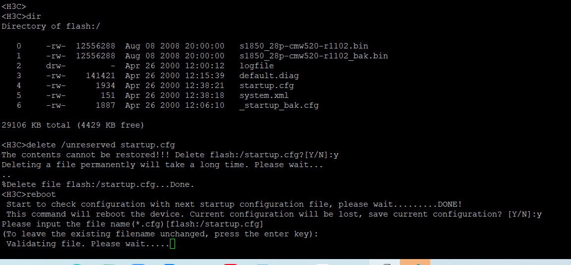

#查看设备当前已存在的配置文件
<H3C>dir
Directory of flash:
   0 -rw-        6244 Jan 08 2013 07:26:03   startup.cfg
   1 -rw-      136628 Jan 08 2013 07:26:03   startup.mdb
   2 -rw-       58704 Jan 03 2013 07:56:22   diag_H3C_20130103-005605.tar.gz

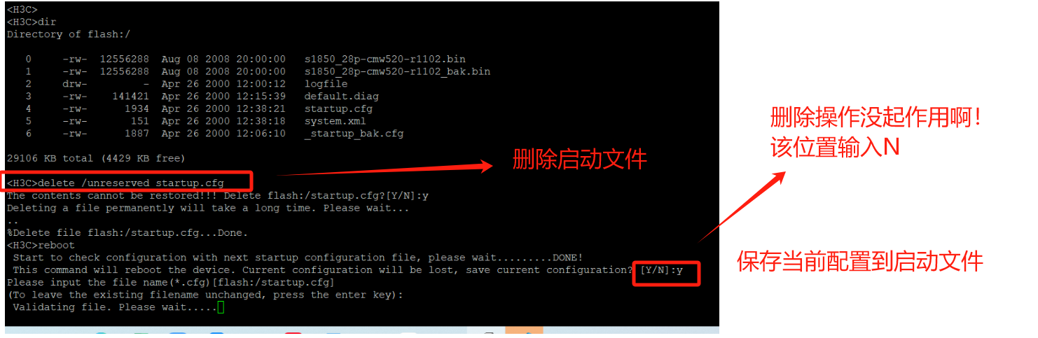

#删除配置文件
<H3C>delete /unreserved startup.cfg   //删除startup.cfg并在回收站不保留
The contents cannot be restored!!! Delete flash:/startup.cfg?[Y/N]:y
Deleting a file permanently will take a long time. Please wait...
%Delete file flash:/startup.cfg...Done.
#重启设备
<H3C>reboot   //重启设备
Start to check configuration with next startup configuration file, please wait.........DONE!
 This command will reboot the device. Current configuration will be lost, save current configuration? [Y/N]:n
 This command will reboot the device. Continue? [Y/N]:y
当设备重新完成,那么设备就在出厂设置的状态

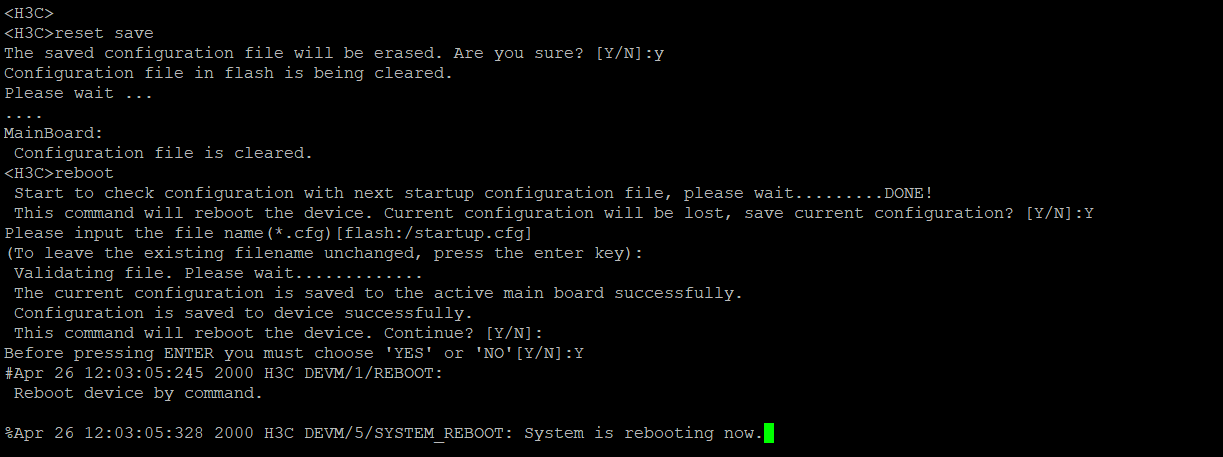

#清除已保存的配置
<H3C>reset save   //清除已保存的配置
The saved configuration file will be erased. Are you  sure? [Y/N]:Y
#重启设备
<H3C>reboot   //重启设备

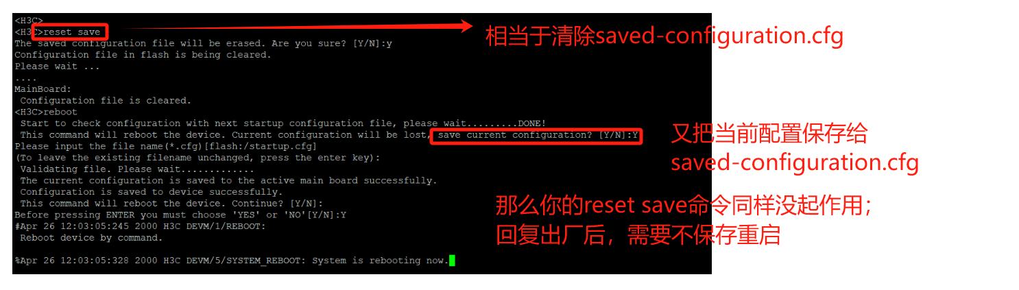

执行上来两条指令后还是不能获取到上级路由器的IP和固定IP进不了管理web页面
