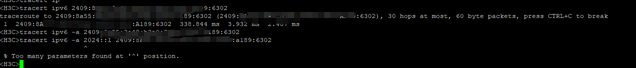

如图:

直接tracert,不指定源IPV6地址试试
tracert IPV6参考:
tracert ipv6 -a ? 看下

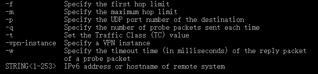

不给回答了~~ <H3C>tracert ? -a Specify the source IP address used by TRACERT -f Specify the TTL value for the first packet -m Specify the maximum TTL value -p Specify the destination UDP port number -q Specify the number of probe packets sent each time -t Set the Type of Service (ToS) value -vpn-instance Specify a VPN instance -w Set the timeout to wait for each reply STRING<1-253> IP address or hostname of the destination device ipv6 IPv6 information <H3C>tracert

tracert ipv6 -a 2024::1 XXXX 这个怎么不可以??哪里错误了呢??

不使用-a 指定ip就可以,指定了就报错
