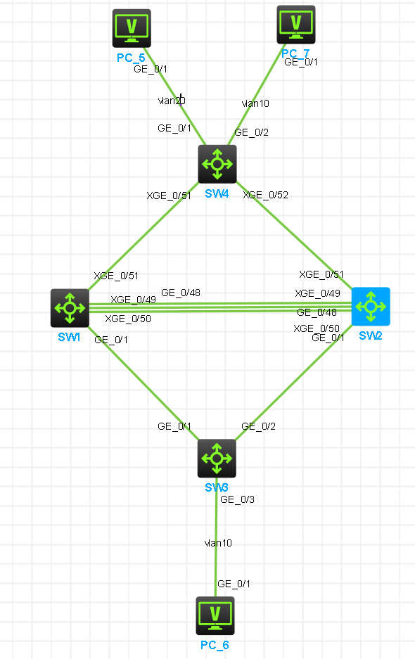

H3C Cloud Lab 软件中调试irf堆叠功能,完成整个配置后测试网络冗余,操作步骤如下:
1、PC5或PC7持续ping PC6,此时网络都是正常的;
2、强行关闭irf主交换机网络,此时PC5或PC7持续ping PC6会中断大约30S后才会恢复网络。
请问如何设置让网络不会出现中断。
谢谢!

line class tty
 user-role network-operator
line class vty
line aux 0 1
line con 0 1
 user-role network-admin
line vty 0 63
radius scheme system
 user-name-format without-domain
domain system
 domain default enable system
role name level-0
 description Predefined level-0 role
role name level-1
 description Predefined level-1 role
role name level-2
 description Predefined level-2 role
role name level-3
 description Predefined level-3 role
role name level-4
 description Predefined level-4 role
role name level-5
 description Predefined level-5 role
role name level-6
 description Predefined level-6 role
role name level-7
 description Predefined level-7 role
role name level-8
 description Predefined level-8 role
role name level-9
 description Predefined level-9 role
role name level-10
 description Predefined level-10 role
role name level-11
 description Predefined level-11 role
role name level-12
 description Predefined level-12 role
role name level-13
 description Predefined level-13 role
role name level-14
 description Predefined level-14 role
user-group system
return
我在g1/0/48配置了 interface Vlan-interface500 mad bfd enable mad ip address 192.168.2.1 255.255.255.0 member 1 mad ip address 192.168.2.2 255.255.255.0 member 2 请问这个是否配置正常
zhiliao_lMYoWm 发表时间:2024-05-16 更多>>
zhiliao_lMYoWm 知了小白
求帮忙,没人知道原因吗
