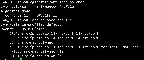

查看聚合负载模式:
锐捷聚合模式
LAN_CORE#show interfaces aggregatePort 1

    Load Balance by: Enhanced Profile

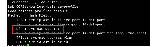

锐捷默认的负载就是 源mac 目的mac 吧 !华三的默认也是,你不用改,要改的话两端改成一致的

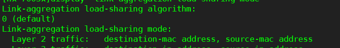

这个是用那个命令查看的
zhiliao_WwEeyR 发表时间:2024-05-28
display link-aggregation load-sharing mode
zhiliao_h907dg 发表时间:2024-05-28
display link-aggregation load-sharing mode Link-aggregation load-sharing mode: Layer 2 traffic: packet type-based sharing Layer 3 traffic: packet type-based sharing

交换机版本不一样吧
