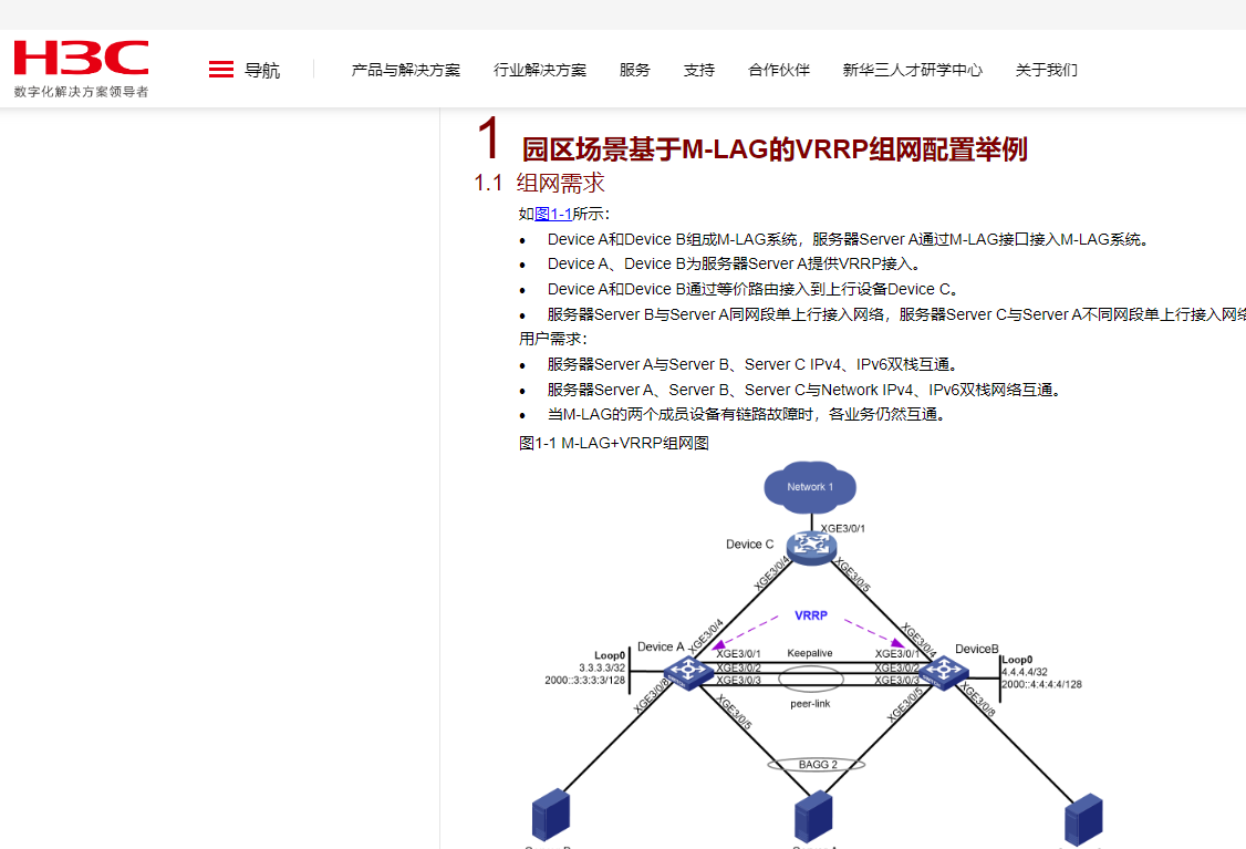

https://www.h3c.com/cn/d_202209/1699110_30005_0.htm#_Toc112838752

以下是配置案例链接,请参考:
https://www.h3c.com/cn/d_202209/1699111_30005_0.htm#_Toc112838763
