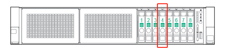

大家好,我这里有台服务器报警DL380需要帮忙确认下报警的磁盘位置,请帮忙一起看下,谢谢
- Port 1I Box 3 Bay 4
  • Status  Degraded (Predictive failure)
    Serial Number WBM4EJ07
    Model EG002400JWJNT
    Media Type HDD
    Capacity 2400 GB
    Location Port 1I Box 3 Bay 4
    Firmware Version HPD6
    Drive Configuration Unconfigured

您好,根据您当前提供的信息截图,当前Box 3 Bay 4硬盘预故障,具体位置如下图
