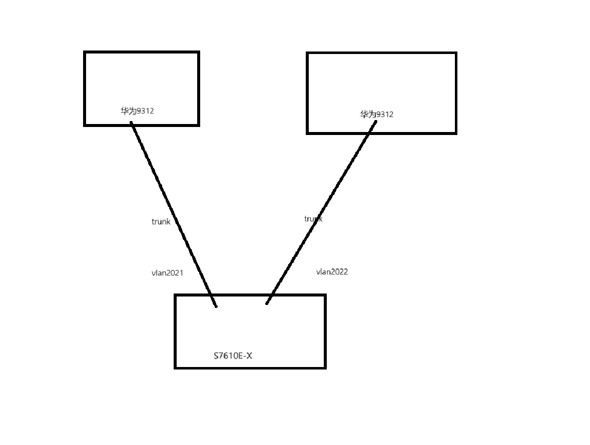

S7610接口配置组播SM后,没有组播流,请问下怎么配置组播
2024-07-16提问
  • 0收藏,2343浏览
vlan 120
 description STB
 igmp-snooping enable
 pim-snooping enable
#interface Vlan-interface120
 description STB
 ip address 10.192.8.254 255.255.255.0
 pim sm
 interface Ten-GigabitEthernet0/0/1
 port link-mode bridge
 port link-type trunk
 undo port trunk permit vlan 1
 port trunk permit vlan 2021
 speed 1000
 duplex full
 interface Ten-GigabitEthernet1/0/1
 port trunk permit vlan 2022
 speed 1000
 duplex full
 interface Vlan-interface2021
 description to-core9312-1-11/0/18
 ip address 10.192.66.102 255.255.255.252
 pim sm
 packet-filter 3101 inbound
 interface Vlan-interface2022
 description to-core9312-2-11/0/18
 ip address 10.192.66.106 255.255.255.252
 pim sm
 multicast routing
pim
 static-rp 218.1.0.10

检查下igmp client和组播服务器侧状态吧
其次如果igmp client在75上的话,少igmp配置呀
仔细检查下吧
