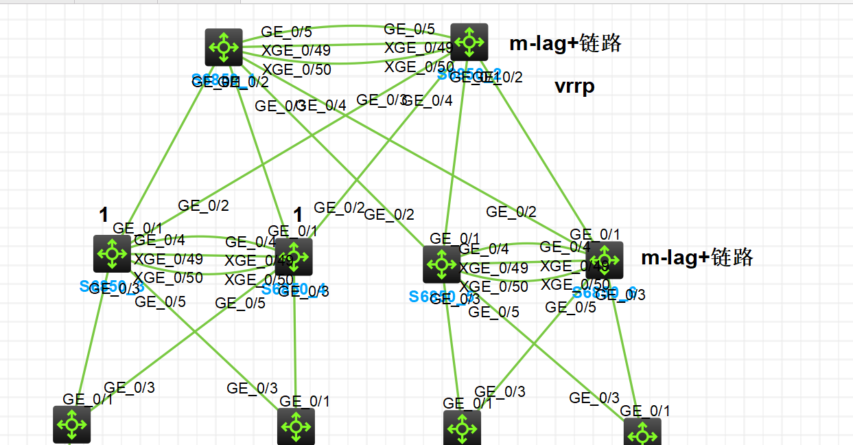

现在组网中配置的是m-lag+链路聚合,m-lag正常,链路聚合加入到聚合口之后,发现有的端口是未选中状态,有的是选中状态。
汇聚的上联口是b100(1口和2口),下连口b2(3口和5口),目前现网中链路有问题。
配置如下
s——6850-3:汇聚

[hj3]display link-aggregation v
Loadsharing Type: Shar -- Loadsharing, NonS -- Non-Loadsharing
Port Status: S -- Selected, U -- Unselected, I -- Individual
Port: A -- Auto port, M -- Management port, R -- Reference port
Flags:  A -- LACP_Activity, B -- LACP_Timeout, C -- Aggregation,
        G -- Defaulted, H -- Expired
Aggregate Interface: Bridge-Aggregation1
Creation Mode: Manual
Aggregation Mode: Dynamic
Management VLANs: None
System ID: 0x8000, 8284-6301-0500
Local:
  Port                Status   Priority Index    Oper-Key               Flag
  XGE1/0/49(R)        S        32768    2        2                      {ACDEF}
  XGE1/0/50           S        32768    5        2                      {ACDEF}
Remote:
  Actor               Priority Index    Oper-Key SystemID               Flag
  XGE1/0/49           32768    2        2        0x8000, 8284-6511-0600 {ACDEF}
  XGE1/0/50           32768    5        2        0x8000, 8284-6511-0600 {ACDEF}
Aggregate Interface: Bridge-Aggregation2
System ID: 0x3e7, 0003-0003-0003
Local:
  GE1/0/3(R)          S        32768    16387    40001                  {ACDEF}
  GE1/0/5             U        32768    16390    40001                  {AC}
Remote:
  GE1/0/3             32768    1        1        0x8000, 8284-81c7-0900 {ACDEF}
  GE1/0/5             32768    2        1        0x8000, 8284-839d-0a00 {ACD}
Aggregate Interface: Bridge-Aggregation100
Local:
  GE1/0/1             U        32768    4        1                      {ACDE}
  GE1/0/2             U        32768    1        1                      {ACDE}
Remote:
  GE1/0/1             32768    32770    40001    0x3e7 , 0001-0001-0001 {AC}
  GE1/0/2             32768    16389    40001    0x3e7 , 0001-0001-0001 {AC}
核心s6850-2配置:
  XGE1/0/49           S        32768    1        1                      {ACDEF}
  XGE1/0/50           S        32768    3        1                      {ACDEF}
Remote:
  XGE1/0/49(R)        32768    1        1        0x8000, 8284-4536-0100 {ACDEF}
  XGE1/0/50           32768    3        1        0x8000, 8284-4536-0100 {ACDEF}
System ID: 0x3e7, 0001-0001-0001
Local:
  GE1/0/1             U        32768    32770    40001                  {AC}
  GE1/0/2             U        32768    32772    40001                  {AC}
  GE1/0/3             U        32768    32773    40001                  {ACG}
  GE1/0/4(R)          S        32768    32774    40001                  {ACDEF}
Remote:
  GE1/0/1             32768    4        1        0x8000, 8284-6301-0500 {ACDE}
  GE1/0/2             32768    1        1        0x8000, 8284-6511-0600 {ACDE}
  GE1/0/3             32768    0        0        0x8000, 0000-0000-0000 {DEF}
  GE1/0/4             32768    4        1        0x8000, 8284-6073-0400 {ACDEF}
