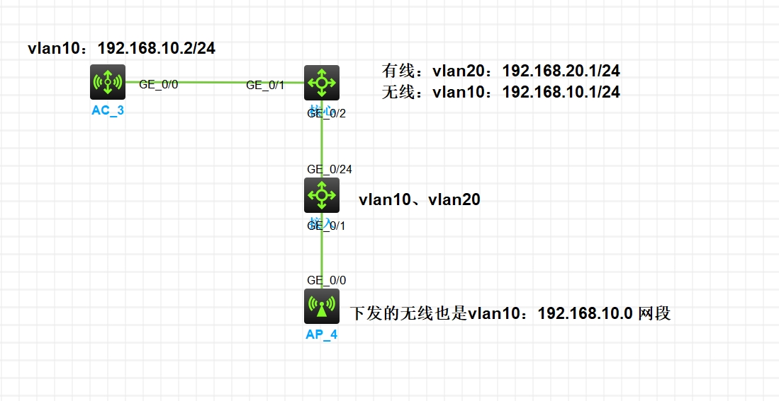

两个网段 vlan10 vlan20。vlan10 是ap下发给终端使用,同时ac和ap同10网段。配置后查看,发现AP是处于 Idle 状态。
配置如下:

AC控制器
version 7.1.064, Alpha 7165
 sysname AC
wlan global-configuration
 irf mac-address persistent timer
 irf auto-update enable
 undo irf link-delay
 irf member 1 priority 1
 xbar load-single
 password-recovery enable
 lpu-type f-series
vlan 1
vlan 10
vlan 20
wlan service-template 1
 ssid test
 vlan 10
 akm mode psk
 preshared-key pass-phrase cipher $c$3$hLR/lmLunEm1J39ZcwseYDVIRdLSoQd+HuBX
 cipher-suite ccmp
 security-ie rsn
 service-template enable
interface NULL0
interface Vlan-interface10
 ip address 192.168.10.2 255.255.255.0
interface GigabitEthernet1/0/0
 port link-mode bridge
 port link-type trunk
 undo port trunk permit vlan 1
 port trunk permit vlan 10 20
 combo enable fiber
 combo enable fiber
 combo enable fiber
 combo enable fiber
interface GigabitEthernet1/0/4
 combo enable fiber
interface GigabitEthernet1/0/5
 combo enable fiber
interface GigabitEthernet1/0/6
 combo enable fiber
interface GigabitEthernet1/0/7
 combo enable fiber
interface GigabitEthernet1/0/8
 combo enable fiber
interface GigabitEthernet1/0/9
 combo enable fiber
interface GigabitEthernet1/0/10
 combo enable fiber
interface GigabitEthernet1/0/11
 combo enable fiber
interface GigabitEthernet1/0/12
 combo enable fiber
interface GigabitEthernet1/0/13
 combo enable fiber
interface GigabitEthernet1/0/14
 combo enable fiber
interface GigabitEthernet1/0/15
 combo enable fiber
interface GigabitEthernet1/0/16
 combo enable fiber
interface GigabitEthernet1/0/17
 combo enable fiber
interface GigabitEthernet1/0/18
 combo enable fiber
interface GigabitEthernet1/0/19
 combo enable fiber
interface GigabitEthernet1/0/20
 combo enable fiber
interface GigabitEthernet1/0/21
 combo enable fiber
interface GigabitEthernet1/0/22
 combo enable fiber
interface GigabitEthernet1/0/23
 combo enable fiber
interface Ten-GigabitEthernet1/0/24
 combo enable fiber
interface Ten-GigabitEthernet1/0/25
 combo enable fiber
interface Ten-GigabitEthernet1/0/26
 combo enable fiber
interface Ten-GigabitEthernet1/0/27
 combo enable fiber
 scheduler logfile size 16
line class aux
 user-role network-operator
line class console
 user-role network-admin
line class tty
line class vty
line aux 0
line con 0
line vty 0 31
domain system
 domain default enable system
role name level-0
 description Predefined level-0 role
role name level-1
 description Predefined level-1 role
role name level-2
 description Predefined level-2 role
role name level-3
 description Predefined level-3 role
role name level-4
 description Predefined level-4 role
role name level-5
 description Predefined level-5 role
role name level-6
 description Predefined level-6 role
role name level-7
 description Predefined level-7 role
role name level-8
 description Predefined level-8 role
role name level-9
 description Predefined level-9 role
role name level-10
 description Predefined level-10 role
role name level-11
 description Predefined level-11 role
role name level-12
 description Predefined level-12 role
role name level-13
 description Predefined level-13 role
role name level-14
 description Predefined level-14 role
user-group system
wlan ap-group default-group
 vlan 1
wlan ap-group group1
 vlan 1
 ap ap
 ap-model WA6320
  radio 1
   radio enable
   service-template 1 vlan 10
  radio 2
   radio enable
  gigabitethernet 1
wlan virtual-ap-group default-virtualapgroup
wlan ap ap model WA6320
 serial-id H3C_A6-60-A0-6E-04-00
 vlan 1
 radio 1
 radio 2
 gigabitethernet 1

模拟器再模拟无线的时候经常出现一些问题的
ap没上线
模拟器ap的型号是WA6320-HCL
建议开启自动上线
wlan auto-ap enable
#自动上线
 wlan auto-persistent enable
#自动固化
baiyan 二段
粉丝:0人 关注:2人
配置有问题,接入的,如果你的ap只是集中注册,你应该接入交换机access划分对应的vlan,而不是trunk。
