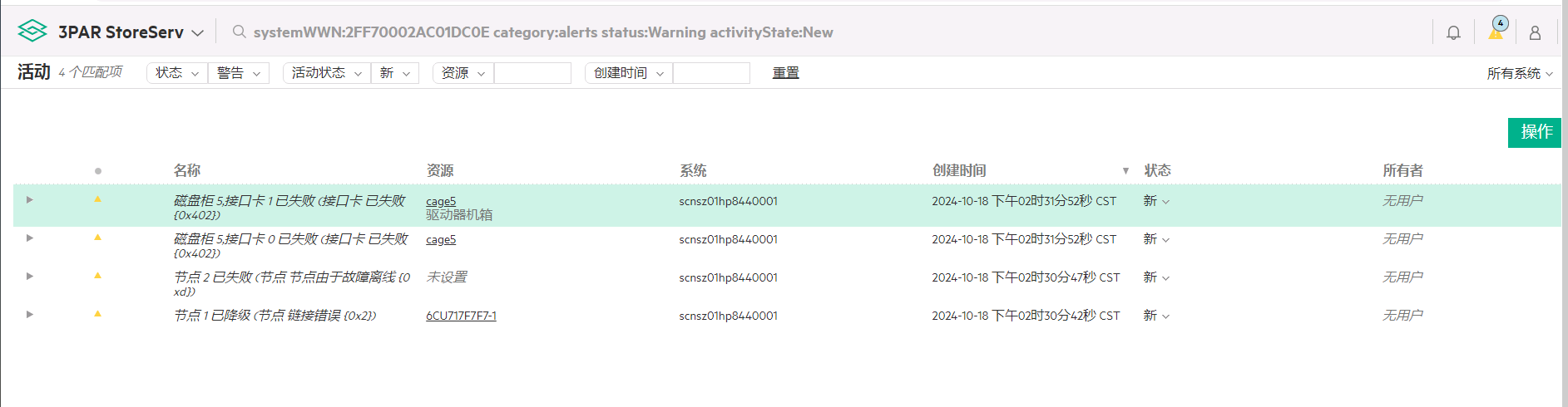

存储3PAR node2故障离线
2024-10-18提问
  • 0收藏,3166浏览
Event ID: 2606428     Node 0     Customer Alert - Yes, Service Alert - Yes
Severity: Major
Time: Fri Oct 18 14:30:46 2024
Event type: Link Establish Alert
Alert ID: 108
Msg ID: 1a001c
Component: Node 0
Event string: Node 0  Failed to establish link to Node 2 from Node 0 link 0
Notification key: 0x01a001c
Event ID: 19431649 Node 1 Customer Alert - Yes, Service Alert - Yes Severity: Major Time: Fri Oct 18 14:30:47 2024 Event type: Node State Change Alert ID: 119 Msg ID: 1a00fa Component: Node 2 Event string: Node 2 Failed (Node Offline Due to Failure {0xd}) Notification key: 1a00xx Spare Part Number: 792654-001
Event ID: 19430429 Node 1 Customer Alert - Yes, Service Alert - Yes Severity: Degraded Time: Fri Oct 18 14:30:42 2024 Event type: Node State Change Alert ID: 105 Msg ID: 1a00de Component: Node 1 Event string: Node 1 Degraded (Link Error {0x2}) Notification key: 1a00xx Spare Part Number: 792654-001
Event ID: 2606347 Node 0 Customer Alert - No, Service Alert - Yes Severity: Degraded Time: Fri Oct 18 14:30:42 2024 Event type: Eagle Link Error Alert ID: null Msg ID: 1a0053 Component: Eagle 0 Event string: Fatal link error between member nodes 0 to 2 posted by node 0 Link 0 config reg [0x00000002] [EN_LTSM] Link 0 status reg [0x40000004] [SND_TO DATA_TX_WD]. Notification key: 0x01a0053 Spare Part Number: UNKNOWN
Event ID: 39363967 Node 3 Customer Alert - No, Service Alert - Yes Severity: Degraded Time: Fri Oct 18 14:30:42 2024 Event type: Eagle Link Error Alert ID: null Msg ID: 1a0053 Component: Eagle 3 Event string: Fatal link error between member nodes 3 to 2 posted by node 3 Link 3 config reg [0x00000002] [EN_LTSM] Link 3 status reg [0x40000004] [SND_TO DATA_TX_WD]. Notification key: 0x01a0053 Spare Part Number: UNKNOWN
Event ID: 19430424 Node 1 Customer Alert - No, Service Alert - Yes Severity: Degraded Time: Fri Oct 18 14:30:42 2024 Event type: Eagle Link Error Alert ID: null Msg ID: 1a0053 Component: Eagle 1 Event string: Fatal link error between member nodes 1 to 2 posted by node 1 Link 1 config reg [0x00000002] [EN_LTSM] Link 1 status reg [0x40000004] [SND_TO DATA_TX_WD]. Notification key: 0x01a0053 Spare Part Number: UNKNOWN
粉丝:4人 关注:43人
更换控制器就可以了
