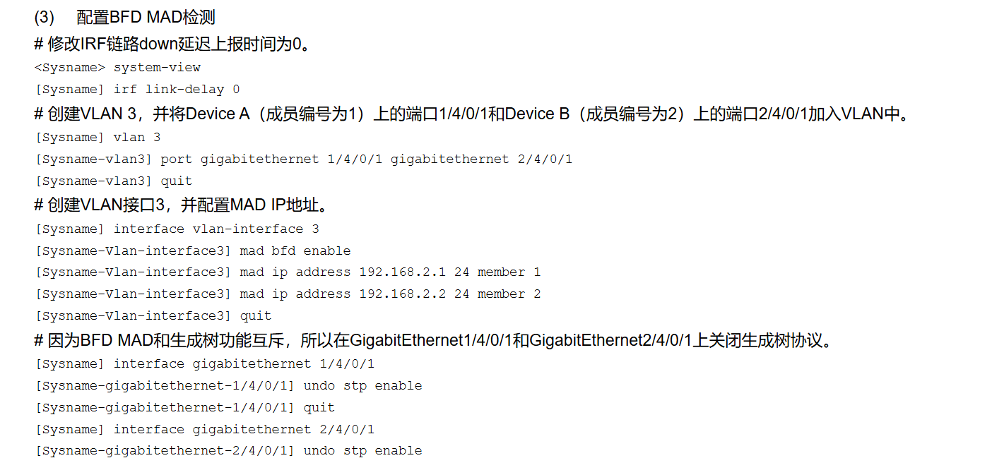

我看IRF BFD MAD各种配置都有,有没有推荐的配置。

(4)     配置BFD MAD检测
# 创建三层聚合接口3。
<Sysname> system-view
[Sysname] interface route-aggregation 3
[Sysname-Route-Aggregation3] quit
# 分别将Device A(成员编号为1)上的端口1/0/1和Device B(成员编号为2)上的端口2/0/1加入聚合组3中。
[Sysname] interface gigabitethernet 1/0/1
[Sysname-GigabitEthernet1/0/1] port link-aggregation group 3
[Sysname-GigabitEthernet1/0/1] quit
[Sysname] interface gigabitethernet 2/0/1
[Sysname-GigabitEthernet2/0/1] port link-aggregation group 3
[Sysname-GigabitEthernet2/0/1] quit
# 配置三层聚合接口3的MAD IP地址。
[Sysname-Route-Aggregation3] mad bfd enable
[Sysname-Route-Aggregation3] mad ip address 192.168.2.1 24 member 1
[Sysname-Route-Aggregation3] mad ip address 192.168.2.2 24 member 2
