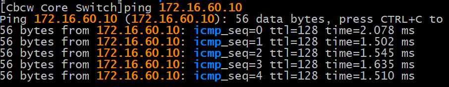

ntp配置如下:
交换机到NTP服务器172.16.60.10能通:
通过debugging ntp-service all得到一下信息,能看出是什么问题吗,也查看了官网的故障排查方法,就是不知道要怎么解决:
*Dec 31 22:58:41:635 2024 Cbcw Core Switch NTP/7/PACKET_RECV:
packet from 172.16.60.10 to 172.16.60.254 on Vlan-interface60
leap: 0, version: 4, mode: 4, vrfindex: 0
stratum: 1, poll: 6, precision: 2^-24
rdel: 0.000, rdsp: 1790773.087, refid: GPS
reftime: eb1e0c64.88ec7937 Tue, Dec 31 2024 14:23:32.534
orgtime: eb1e8521.a23fa61a Tue, Dec 31 2024 22:58:41.633
rectime: eb1e0c64.88ec7937 Tue, Dec 31 2024 14:23:32.534
xmttime: eb1e0c64.88ed9a1e Tue, Dec 31 2024 14:23:32.534
inptime: eb1e8521.a2af32ef Tue, Dec 31 2024 22:58:41.635
*Dec 31 22:58:41:636 2024 Cbcw Core Switch NTP/7/ACL: Access restrict: 0x00000008.
*Dec 31 22:58:41:636 2024 Cbcw Core Switch NTP/7/AUTH: Received a packet at 119384873, from 172.16.60.10, mode 4, key ID 00000000, length 48, authentication result 0
*Dec 31 22:58:41:636 2024 Cbcw Core Switch NTP/7/VALID: The packet from 172.16.60.10 failed the validity tests 0x00011440.
粉丝:8人 关注:0人
手动调个相近的时间再同步
