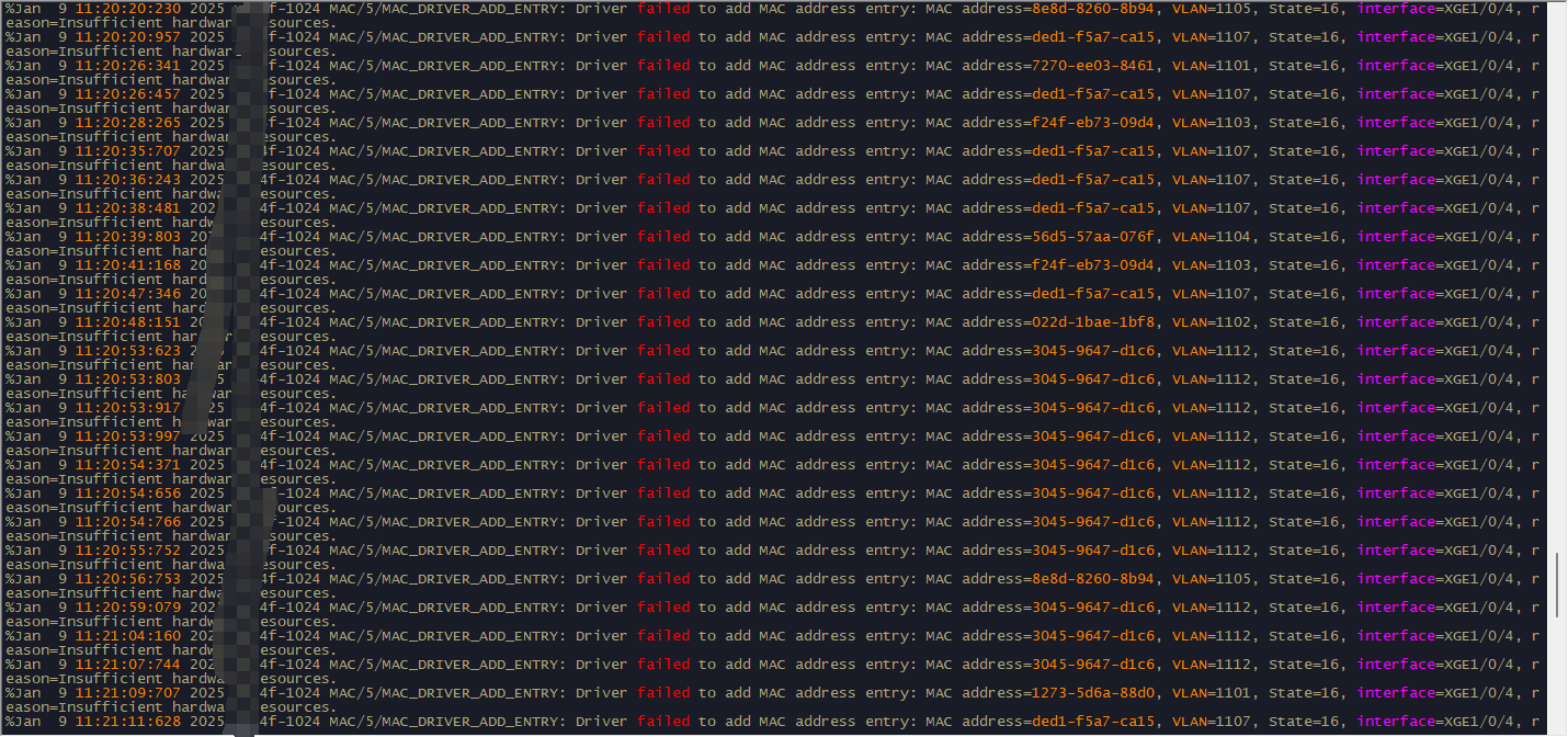

WT1024-X 查看日志显示 硬件资源不足 这有办法解决吗
  • 0收藏,1671浏览
MAC/5/MAC_DRIVER_ADD_ENTRY: Driver failed to add MAC address entry: MAC address=50a6-d8d2-fb9f, VLAN=1112, State=16, interface=XGE1/0/4, reason=Insufficient hardware resources.要怎么解决
