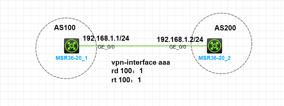

1.已经试过MSR3620和VSR88,问题都一样
2.设备配置:
AR1基本配置:
ip vpn-instance aaa
 route-distinguisher 100:1
 vpn-target 100:1 import-extcommunity
 vpn-target 100:1 export-extcommunity
interface GigabitEthernet0/0
 port link-mode route
 combo enable copper
 ip binding vpn-instance aaa
AR2基本配置:
ip vpn-instance aaa
 combo enable copper
 ip address 192.168.1.2 255.255.255.0
3.测试连通性
[AR2]ping -vpn-instance aaa 192.168.1.1
Ping 192.168.1.1 (192.168.1.1): 56 data bytes, press CTRL+C to break
56 bytes from 192.168.1.1: icmp_seq=0 ttl=255 time=0.878 ms
56 bytes from 192.168.1.1: icmp_seq=1 ttl=255 time=0.622 ms
56 bytes from 192.168.1.1: icmp_seq=2 ttl=255 time=0.449 ms
56 bytes from 192.168.1.1: icmp_seq=3 ttl=255 time=0.576 ms
56 bytes from 192.168.1.1: icmp_seq=4 ttl=255 time=0.963 ms
4.EBGP邻居建立配置:
AR1的BGP配置:
bgp 100
 router-id 1.1.1.1
 ip vpn-instance aaa
  peer 192.168.1.2 as-number 200
 address-family ipv4 unicast
  peer 192.168.1.2 enable   //报错
Peers don't exist.
AR2的BGP配置:
bgp 100
 router-id 1.1.1.1
 ip vpn-instance aaa
  peer 192.168.1.1 as-number 100
  peer 192.168.1.1 enable   //报错
Peers don't exist.

AR2的BGP router-ID 为2.2.2.2,复制的时候忘记修改了
可以实现,命令的时候后面加?看下命令提示
peer 192.168.1.2 enable ?没有东西
凤凰涅槃 发表时间:2025-02-05 更多>>
