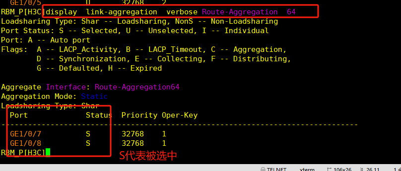

S7506E如何查看聚合口的成员口是否被选中,命令是啥
dis link-aggregation verbose
<Sysname> display link-aggregation verbose route-aggregation 2
Loadsharing Type: Shar -- Loadsharing, NonS -- Non-Loadsharing
Port Status: S -- Selected, U -- Unselected, I -- Individual
Port: A -- Auto port
Flags:  A -- LACP_Activity, B -- LACP_Timeout, C -- Aggregation,
        G -- Defaulted, H -- Expired
Aggregate Interface: Route-Aggregation2
Aggregation Mode: Static
  Port             Status  Priority Oper-Key
  GE1/0            S       32768    1
  GE2/0            S       32768    1
  GE3/0            S       32768    1

dis link- v
